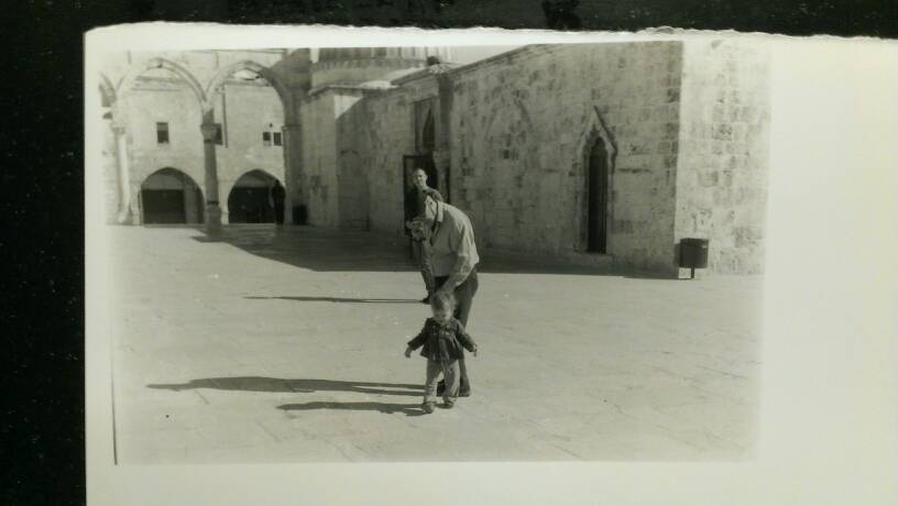

I don't think it is a problem of contrast per se, it is a problem with blocked highlights. Look at image #3: The face of the bay is not too contrasty and the wall in the background is in normal range. But the floor is blocked.
This means that the film is overexposed and perhaps overdeveloped. Normally we found underexposed negatives at beginners bt here we seem to see the other way. The high printing times point in the same direction. I recommend with the next film nothing to change but to make three negatives of each scene, one metered, one metered minus one stop, one metered minus two stops.

Finally, since the beginning of this thread, all we've seen are prints that are too contrasty and were made with Grade 3 filter. Highest priority action is: try grade 1 and show us the results.
Your print exposure times indicate film over-exposure and drastic over-development.
My thoughts exactly.
The blocked up highlights are from HUGE negative over-development.
Normally over-exposure is not an issue. You just get longer print times since you have to shine through those dense highlights.

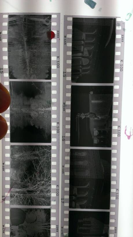

Your negatives look underexposed (no shadow detail) and grossly over developed (blown highlights and midtones pushed way up on the scale). Back way, way off on the development.
Mistaken 68f for 68c, maybe? :smile:
Well, I printed again at grade 1.5, and it looks much better (lacks contrast if anything). It did take 80s for a postcard size print, so that's the sting in the tail (but one I can put up with). In the picture it's clearly visible that the corners are lighter, which I'm sure isn't a development issue. Anyone got any ideas? It was at f/2.8. I've also attached the negs, which are clearly very dark so I guess that was the issue (they are on a lightbox). uploadfromtaptalk1397636605596.jpguploadfromtaptalk1397636629654.jpg

So as far as print grade goes, it looks to me like you are not too far off. That means your film development is reasonably close.
Going forward I'd develop the next roll of film the same way did and do an exposure test.
Using box speed as a reference, I'd start at maybe 4-stops under and given what you showed here come up a 1/2-stop at a time to 2-stops over. All the shots need to be of the same scene (This is where a 12-shot roll really helps.) If you are using a 24-shot roll, do this for two scenes, 36-shot roll three scenes. It may help to put a note in the scene indicating what EI is being shot.
After you develop that roll use a loupe or magnifying glass and look for shadow area detail in the new negs, then try to print the thinest negative that seems to have good shadow detail, use grade 2. Print the negatives on either side of that one and see what you like better, the loupe won't tell you everything.

Your negatives are usable, they don't look too dark, I would say little darker than normal. I was getting nice prints from even darker overexposed and overdeveloped negatives. When needed I exposure paper for 10 or even 15 minutes.
Try to use grade 2, or 2.5 and longer exposure. Recently I complained here about getting too high contrast on fixed grade paper (grade 2) - and most of that was solved with proper (longer) paper exposure and change of paper developer.
Agree that after seeing the negs they look usable.
Exposure looks ok too.
It's all about the printing to bring something good from those negatives. Lower contrast grade, and practice some burning techniques.
