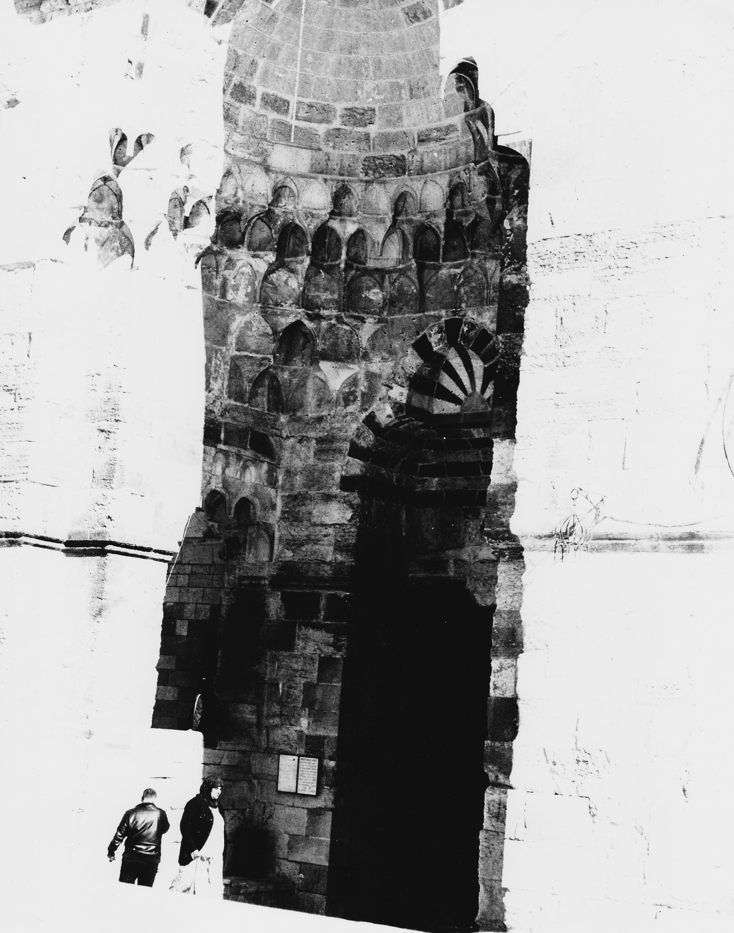

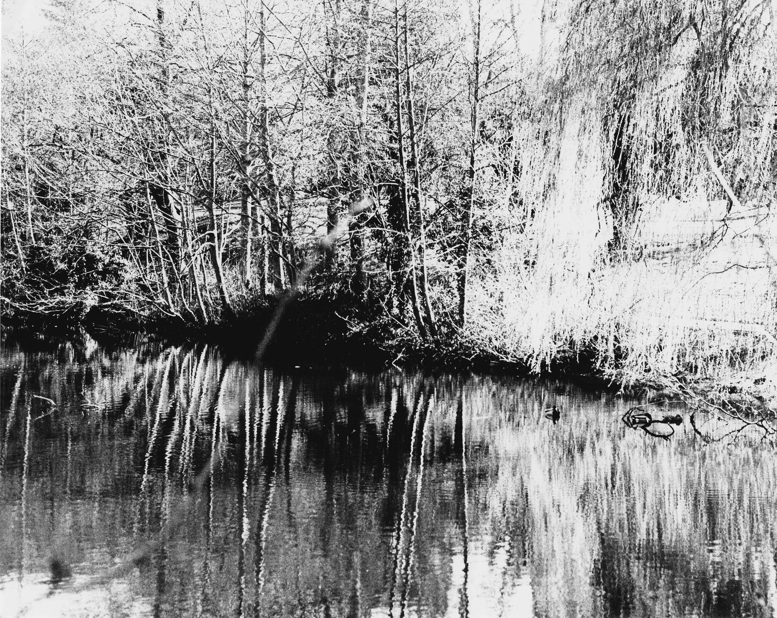

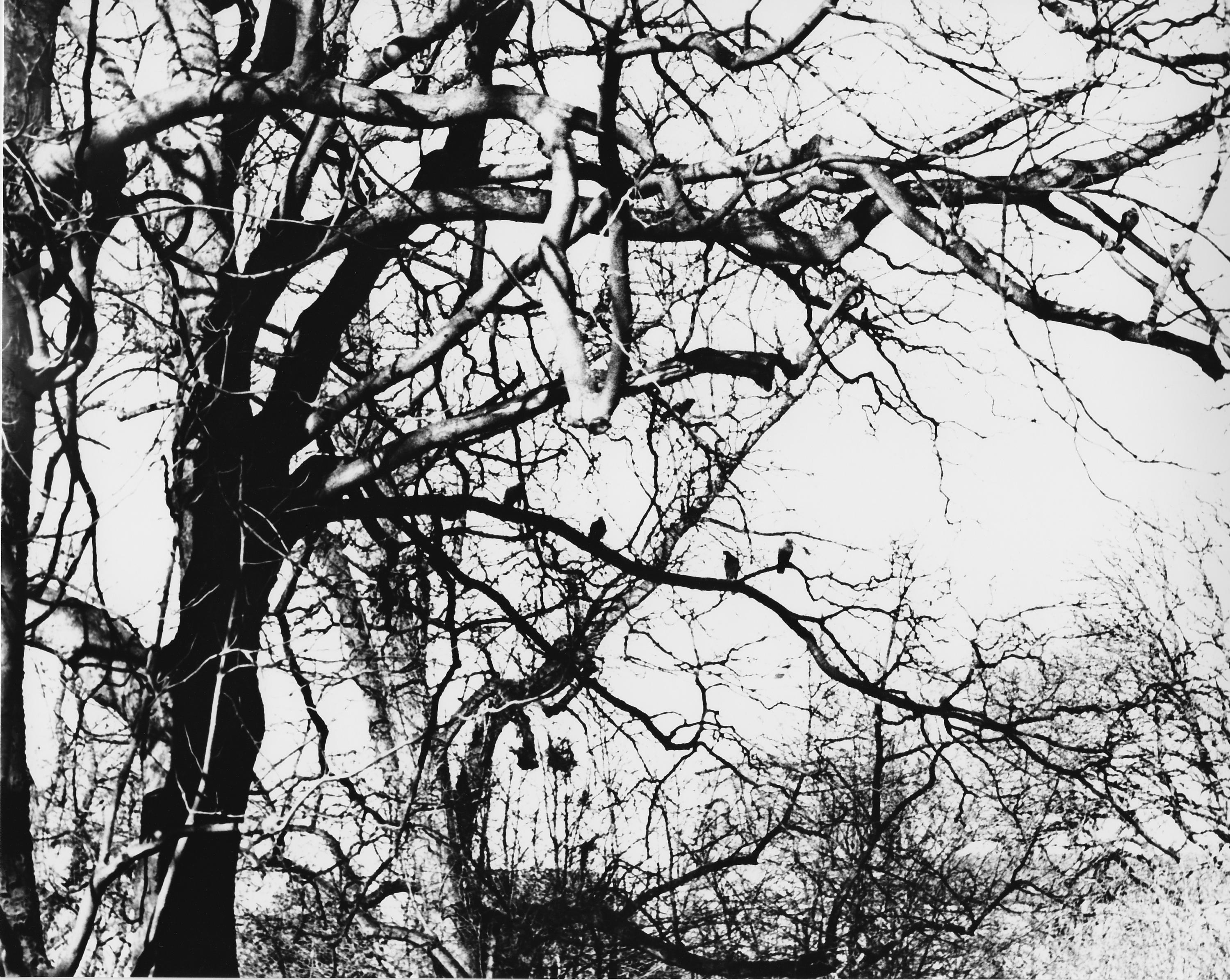

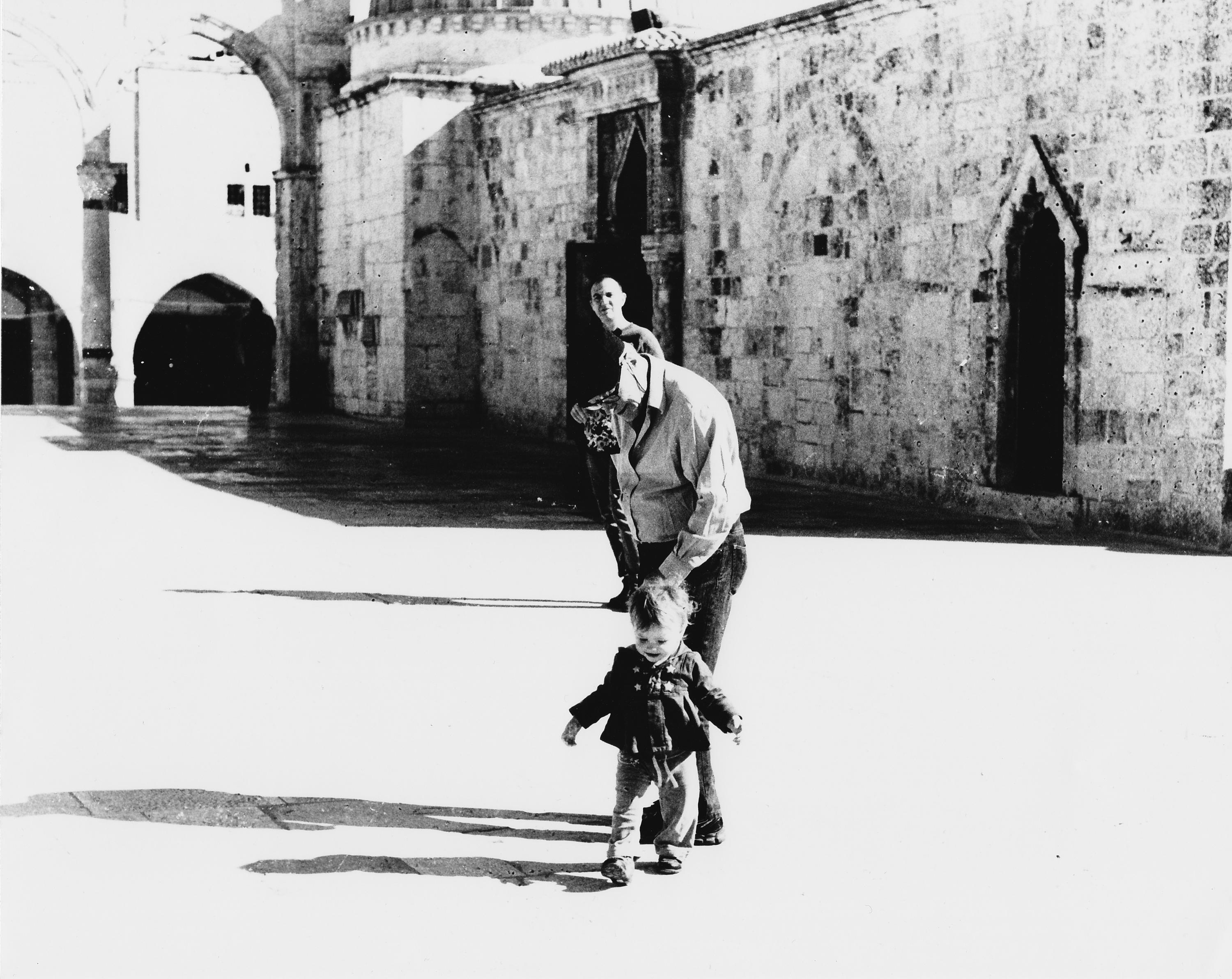

Hi all
I'm having problems with my wet prints, which have extreme contrast and very little or no detail in highlights. I don't think this is an exposure issue as areas of each photo are fine, but light areas such as the floor or sky are often coming out white, with detail only in shadows. It's not as bad as the scans make out (prints are also a lot warmer), but bad enough to be an issue. All the photos were taken in quite strong sunlight so I was expecting quite high contrast but nothing like this - however the negatives are slightly overexposed (say 1/2 - 1 stop), I don't know if it has something to do with this. I am using Kentmere 100 and Ilfosol 3 with the recommended time. Anyone got any advice? I was thinking of using a yellow filter or changing the developing time but I'm quite new to this.
Also, some of the prints have some black spots on them. If anyone knows what this is I'd be happy to know, but it seems to have been a one time thing (I've only seen it on one roll) so I'm not too bothered.
These were taken on an Canon FTb with the 50mm 1.4 SSC, although I'm also using a 35mm 2.0 SSC.

400 film copes with sunlight better.
Try a soft working developer as well.
Dev for 10% less if you are going to scan.

I think you could reduce the paper contrast when printing by a grade. If you are using multigrade paper, then yellow filtration will do this. The Ilford paper data sheets give the amount of filtration required to achieve a particular paper grade - Grade 0 has low contrast and Grade 5 has high contrast. If you printed these without a filter then they should be around Grade 2 and I would suggest you try Grade 1. If you're not already using a filter for the print then you will need to increase the exposure to compensate for the light loss of the filter - I expect by half a stop to one stop for Grade 1.
It would be a good idea to use a yellow or orange filter while taking photos with blue sky in them. This will help by darkening the sky somewhat (less with a yellow filter, more with an orange one).
If the problem persists you could reduce the film development time, perhaps to the "N-1" (1 stop pull) time on you developer data sheet. But I would try the other options first because if you have less contrasty pics on the same roll you would not want to reduce their contrast any more.
Don't worry about the exposure, half to one stop over exposure is quite normal and won't hurt the prints at all.

What does the shadow detail (if any) look like on the negatives? The most common cause of that condition is under-exposure and over-development. First thing to do is re-print them on lower grade paper. If they maintain blacks then exposure was probably OK. If the blacks go to gray when printed on lower contrast paper then the negatives were probably under-exposed.

The long exposure time may truly indicate film over-exposure, over-development, or a combination of both.
If I remember correctly most halogen bulbs dim very little before failure, so I don't think it is likely the bulb, but it's not impossible.
Your Grade 3 setting here though could be a distinct part of the issue. If contrast is too hard, like your examples, you want to adjust the other way, toward 0 rather than 5.
Try dialing in full yellow instead and zero out the magenta completely. Then print until you get the highlight detail you want. If you can print the detail you want by doing this the negative is not over-exposed into oblivion.
Look at the over all print. Does it have the snap you want across the mid-tones?
From there, look at the shadow areas. Is the detail you want there? Too black? Too gray?
Too black/not enough detail in the shadows at this point would indicate over-development of the film.
Too gray would mean that that full yellow is too soft a paper grade. If so cut the yellow setting in half and print again, judge the new print and adjust again as needed.
When done report back to us. :D

It won't help improve your current negs which you will have to live with but if your scans are accurate replicas of your negs then I'd say that you have both over-developed and over-exposed. In the scan with people which looks to have contrasty light conditions I'd have expected the shadows to be a lot darker in those conditions, hence why I say that it looks quite a lot over-exposed.
Your scans and print exposure times to get a reasonable looking print suggests a lot of over-developed of the film where the highlight are almost paper white.
I'd be tempted to reduce exposure by about a stop or at least half a stop. The easiest way to do this might be to set the film speed to half a stop more than the box speed so if it's a 400 film set the ISO to 600. I'd then reduce the development time by at least 30% on the next film
Again I have to base this on your scans but you can check on this by looking at the black parts of the negative which represent highlight detail. If these areas of the neg are almost black this confirms over-development.

Your print exposure times indicate film over-exposure and drastic over-development.

To the OP: Trying to solve your problem, please don't be offended. Please double check that you used the correct dilution for the developer. The MDC (Massive Development Chart) states:
Kentmere 100 Ilfosol 3 1+9 100 5 20C
Kentmere 100 Ilfosol 3 1+14 100 7.5 20C
You'll have time later to learn fine tuning; these should be good starting point to obtain decent images.
Just to be sure, 1+9 means 1 volume from the Ilford bottle mixed with 9 volumes of water.
Also check your thermometer against any other thermometer: leave them in proximity for 5 min before taking readings.

I am in basic agreement with Rick and ic- here. While the photographs may be improved somewhat by printing at lower contrast, that does not seem to be the issue at hand. The negatives are the crux of the matter. First deal with exposure, then development – then printing.
You have a couple of major misconceptions about the negs. The pix, in fact, show no shadow detail (except weirdly in the human shadows) and the highlights are blown as well. I doubt the negs do either. The filtration advice offered in some posts, during film exposure, will do nothing to help you achieve less contrast. Yellows and oranges will only help you achieve micro contrast resolution in brightly lit microcrystalline textures like snow, and separation of visualized grey tones in the sky. This is also not an issue of film speed. Any B/W panchromatic film of any speed should give you viable results if exposed and developed correctly. (I shoot slow speed films, 25 in 120 and 125 in LF, all the time in contrast at least as high as evident in your pix)

Well, I may not be understanding you ROL.
The OP's examples though seem to have been done at grade 3 so the choice of print grade for the examples we have been shown is a suspect IMO, that's not a given yet though, and the OP can get reasonable results with grade adjustment but we don't know what grade that is, and the prints take a fairly long times compared to what I'd expect, IMO indicating really thick negatives. So it would seem to me that it would be odd to find a lack of detail in the shadows.
Forgot to mention I'm using multigrade paper (Ilford MGIV) and an LPL VC6700 enlarger. I've tried changing the enlarger grade settings and can get reasonable results, but I'm having to use ridiculous exposure times (90s for grade 3 at 8x10 size). Could the enlarger itself (the bulb, the lens etc) be the problem? Obviously with any filter I'd need even longer times...
