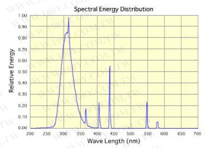

The filter comes off. The bulbs are labeled:
Sankyo
G8T5E
Dangerous for Skin and Eyes
UV-8
Hg
Here is the emission spectrum:
Do you think this will work?
How much of an issue is eye/skin protection? Do I need to wear sunscreen around this thing?

I would just not look directly at the bulbs. And don't lie down naked next to the thing.
Yeah, you might be able to get some more effective juice with that filter plate off. I'm also curious to see what it does to your tone scale, though 306nm is still low, maybe you get enough longer wavelengths to make a difference.

Not sure if you saw this, but I uploaded the spectrum of the bulbs since my original post.

Yeah that spectrum looks like standard mercury with some other stuff down at ~300nm that I guess could be tube phosphorescence from the lower lines.
Unrelated trivia: I use the 435 (blue) and 546 (green) lines found in normal fluorescent lamps as calibration standards; the fluorescents contain mercury vapour and all colour photographers know very well what these lines can do to your colour temperature. The mercury in 'energy-efficient' fluorescents is the source of my ire about environmentalists telling us to use them instead of incandescents: the fluorescents involve mercury which is a particularly dangerous substance in neurochemistry because it easily crosses the blood-brain barrier. Very nasty stuff even in minute quantities.
Second piece of trivia: these lines are also intimately familiar to me from photolithography; for years, each successive jump in resolution of the fabrication process for integrated circuits was just the jump to the next lower wavelength in the mercury spectrum. A big part of my current research is to develop UV photolithography beyond the mercury lines.

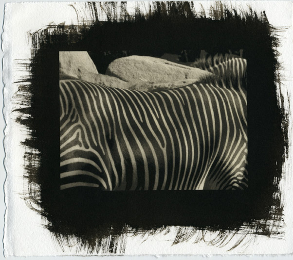

So I used chart throb to develop a curve and tried a print using the UV unit and a looooong exposure (90 minutes). Here's what happened:

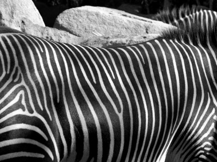

This is the digital photo I orginally used
And if you want to see a higher resolution version of the print, go here
I'm not at all impressed with the results. Is it the curve? A bad starting image? Bad technique?
I'd appreciate your thoughts.

Why are you not impressed? To my eye, the tonal transitions in the hybrid print look way more sophisticated than in the starting digital file. The digital tone scale looks much too linear to me. I think you curved it quite well. Maybe you just want slightly deeper blacks. But I like it.

Thanks for the support! I think I was disappointed in some of the more obvious digital artifacts: some of the transitions on the zebra's coat, and the whole area at the top right is pretty pretty blocky (for lack of a better word) looking. Is that just par for the course using a far-from-state of the art epson 1280?

Oh - I forgot to mention that the print size is 4x5 inches.

I'll have to refrain from commenting in detail, I am sitting at a laptop now! But my first reaction was that I much prefer the tone transitions in the print. Maybe others can comment more specifically....

It's hard to tell from scans of course, but if the scans are comparable, then it looks to me that the whites (lightest tones) in the print are considerably darker than the whites in the digital file and also considerably darker than the whites in the scanned step tablet from before. Was that periclimines' objection to the print, or something else?

Peri, along the lines of what Katherine said, which is very true: it's tough to see the blocking on screen or to comment in depth on tonality. All we can really see clearly is that the whites aren't so white and the blacks aren't so black! For me it kinda works, I like the subtlety of the scale, but that's not to say that it isn't as good as it could be. Ultimately you have to be the one to make that call because we're just looking at a glowing screen, you know.
What you can do, to satisfy yourself that you've done the best possible job with your tone scale, is to embed a tone gradient beside your image. Then when all is said and done you have a reference of Dmax/min and you can ask yourself if work for further improvement is warranted.
Now, I opened your image in PS and looked at the histo and it isn't particularly discontinuous, confirming that you don't have really obvious banding per se. But on the other hand, just using the wand at low tolerance, it is clear that the tones are kinda grouped / compressed together across the scale, which creates a posterized impression or at least a feeling of flatness. In other words, you could probably use some more contrast between the whitest whites and the blackest blacks. The challenge is to do that - extend the scale- while maintaining good continuous transitions. If you embed a scale in your image then you will be able to judge more quickly.
Having said that, are you really expecting the print to resemble the digital image? If so then your best chance, in my amateur/ limited experience, is a glossy RC silver print. I am not advocating that, I am just saying, you have to compose and previsualize for the entire process and if vivid white/black striping is an essential part of the image in your head then maybe you should go silver with it. For me I like the subtlety of your current print because the zebra and background almost morph together, tonally, so we don't get the idea that it's just a zebra.

My two cents on the two prints would be that the highlights in the alt print don't get anywhere close to the uncoated paper white, and they are pretty yellowish-brownish. So, assuming the print is properly cleared, that would indicate that the dense parts of the digital neg are not dense enough, which would be in line with Keith's theory that at such extended exposure, it's hard to get enough blocking. But one question - is this develop-out or Ziatype? Zia's can dry out enough during a long exposure to throw things off.
I'd endorse Keith's suggestion of printing a test wedge, but I'd go farther and leave off the print... Just generate an evenly spaced 21-step strip and test, test, test. I lifted mine from the calibration routine in QTR, but it would be easy to make one too. That way you can tease out what is due to the material, what to the process, and what to your curves.
