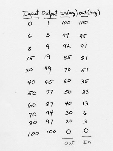

Having just read Clay Harmon's PDF (never came across it while I was just starting digi-neg stuff), and having re-read Ron's, one thing jumps out at me. Neither takes advantage of the curve linearization built into QTR.
I've been meaning to write up a larger piece on my QTR method (which takes advantage of the built-in linearization), but I never got around to it. So I'll touch briefly on this one point.
A lot of people believe that you can't use the QTR linearization functions, because they're designed for positive images, not negatives. Which is true, sort of. You can't use your L* or density values directly as-measured. You have to do a little gymnastics. Ron comes so very close...he's already done the inversion necessary to make it work with linearization in QTR. But instead over-complicates it (IMO) by going to Photoshop curve route.
For reference, I've included the table in question from Ron's PDF (I hope he doesn't mind). The column he has labeled "Out (Neg)" represents the mathematical transformation that is required to go from measured values from the print ("Out" column) to what would need to be entered into the linearization field in QTR...with 1 exception. The QTR linearization data *must* be uniformly spaced (i.e. 0%,10%,20%,30%, etc.) instead of the arbitrary measurement points Ron has selected.
This leaves the gray curve for creative adjustments, if desired, instead of a convolution of process linearization and creative adjustment. That's just my opinion...the act of creating the curve in photoshop may benefit people who think more graphically/visually instead of more analytically. I definitely fall into the 2nd category. Certainly, no one should change what they're doing just 'cause I said so. But I wanted to provide some food for thought. After all, why not use the tool (QTR) to it's fullest?
Happy to answer any questions via PM or in another thread...sorry to the OP for the hijack.
--Greg

The 'Build QTR Curve' script only reads the 21step wedge and then creates an .acv file ( photoshop curve ) that you can use as the 'grey curve' in your QTR .qidf file. Also after you create that 1st .acv curve, you will need to adjust it. So it will be easier to adjust a curve you created than one the computer figured out.
As Paul said, look for Ron's manual or better yet buy his new book ( it's only $10 ) and it gives step by step instructions for creating the table that Greg posted. The final two columns ( read from the bottom up ) are the values for the .acv curve or can be manually entered into QTR.
--Greg

I have not tried the linearization in QTR, but you've peaked my curiosity. I would be interested in reading more about your technique.

Where can we find info on using QTR's linearization? How do you come up with a curve? Is it the same way Ron does it, via scanner readings...?

Pages 23-24 of the QTR user guide discusses it for positive prints:
http://www.quadtonerip.com/User Guide.pdf
In short...you can measure the steps in your step wedge print with a reflection densitometer, a scanner (color scan...measure the L* values--Lab mode--in Photoshop), or, if you're already an uber-color-geek, measure L* directly with a spectrophotometer like the i1Pro, DTP20, ColorMunki or others.
Measurements must be uniformly spaced, and are entered in the Linearization tab (in QTRgui) or on in a LINEARIZATION = "..." command line in the QTR text file. The values should go from paper white to max black. So for L*, the values decrease, and for density, the values would increase.
QTR computes the linearization curve from your measurements, and it's that easy for prints. But for negatives, you have to massage the data a bit. You *can't* just enter the values from black to white, instead...it breaks things. Instead, you have to reverse the increments from one step to the next. In the graphic I posted above, the numerical transformation required is illustrated in the transformation between the "Out" and "Out (Neg)" columns...though the top entry in "Out (Neg)" should really be 99, not 100. I set up a super-simple spreadsheet that I can just paste the values into. Hope that makes sense.
Thread successfully hijacked...just call me DB Cooper. I'm gonna jump out now and go shoot some pics.
