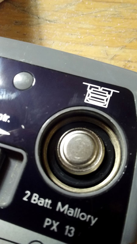

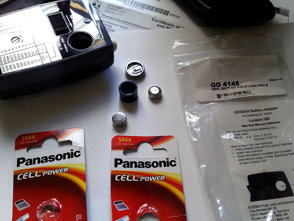

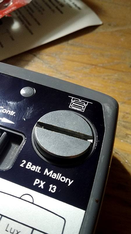

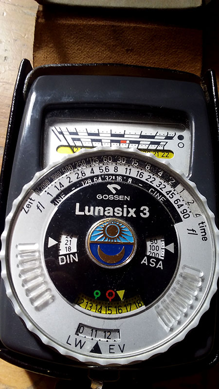

I have just purchased from B&H a GO4145 battery adaptor for my Gossen Lunasix 3.. it has come with SR44 batteries - but it does not fit!!.
I am trying to communicate and explain to B&H but being in Australia it is proving difficult and taking days.
The kit is designed for a Luna Pro S.. but my searching suggests it is the same as Lunasix 3 - but maybe not. The problem is the batteries stick up outside of the holder and I cannot close the battery cover. Any ideas from anyone please to help with this problem. Thanks

IIRC, the SR44 batteries should fit completely within the adapter. Yours seen to be sticking up above the lip.
Is there something stuck in the adapter? Are you sure the batteries are in the right way?

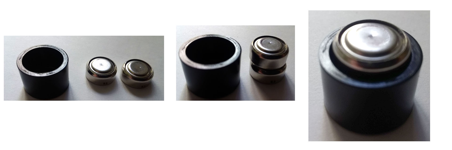

Yes - that is the problem.. and I have tried them both ways..... I just cannot get the lid screwed down...

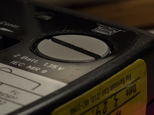

I had one of those in a grey Luna Pro (the Lunasix 3 is called Luna Pro in the USA) and it worked fine, the lid screwed all the way down. I use it in a Luna Pro S (Lunasix 3s) now.
MattKing
Apr 24, 2005
54,718
Delta, BC Canada
In your photo, the batteries look to be upside down (I think).

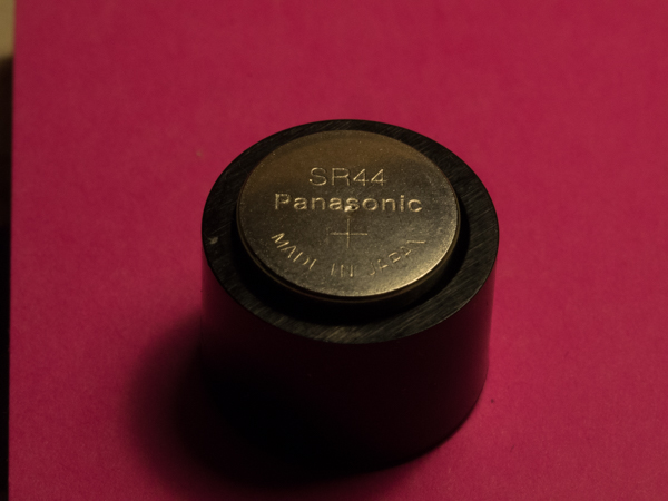

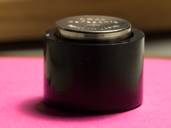

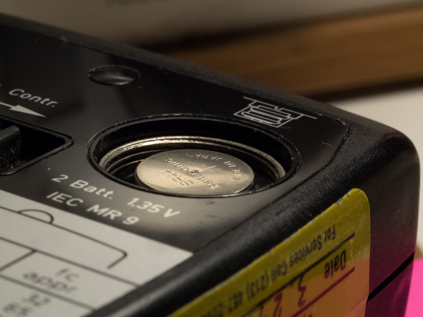

I have the exact same kit for my Lunasix 3s (same as the 3 from a battery/adapter point of view). First off, the plus side of the SR-44 is inserted up (visible after insertion). After inserting the batteries into the adapter, the battery stack is sticking out roughly 1.8mm. Putting the adapter with batteries into the meter, pressing down against the spring contact gets the top of the battery to about the middle of the threaded area.

Thankyou very much Plumerl... GOT IT!!.. I was not pressing down hard enough - quite a bit of force needed.. and it only half closes but is OK. And as Matt King suggested earier - I did have my batteries upside down.
Thank you everyone - I am now very happy.

Likely the problem is pressing hard AND finding the thread start.
In this case one should twist the cap in reverse until it snaps and only then twist it the right way.

But if closing the battery case cover is a real problem, consider using SR43/386 cells instead of SR44/357s. SR43s are the same diameter, same voltage, and a little thinner. Lower capacity, though, so shorter life.
