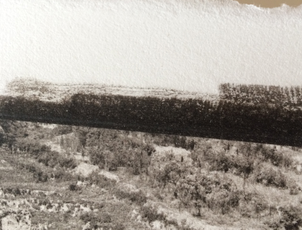

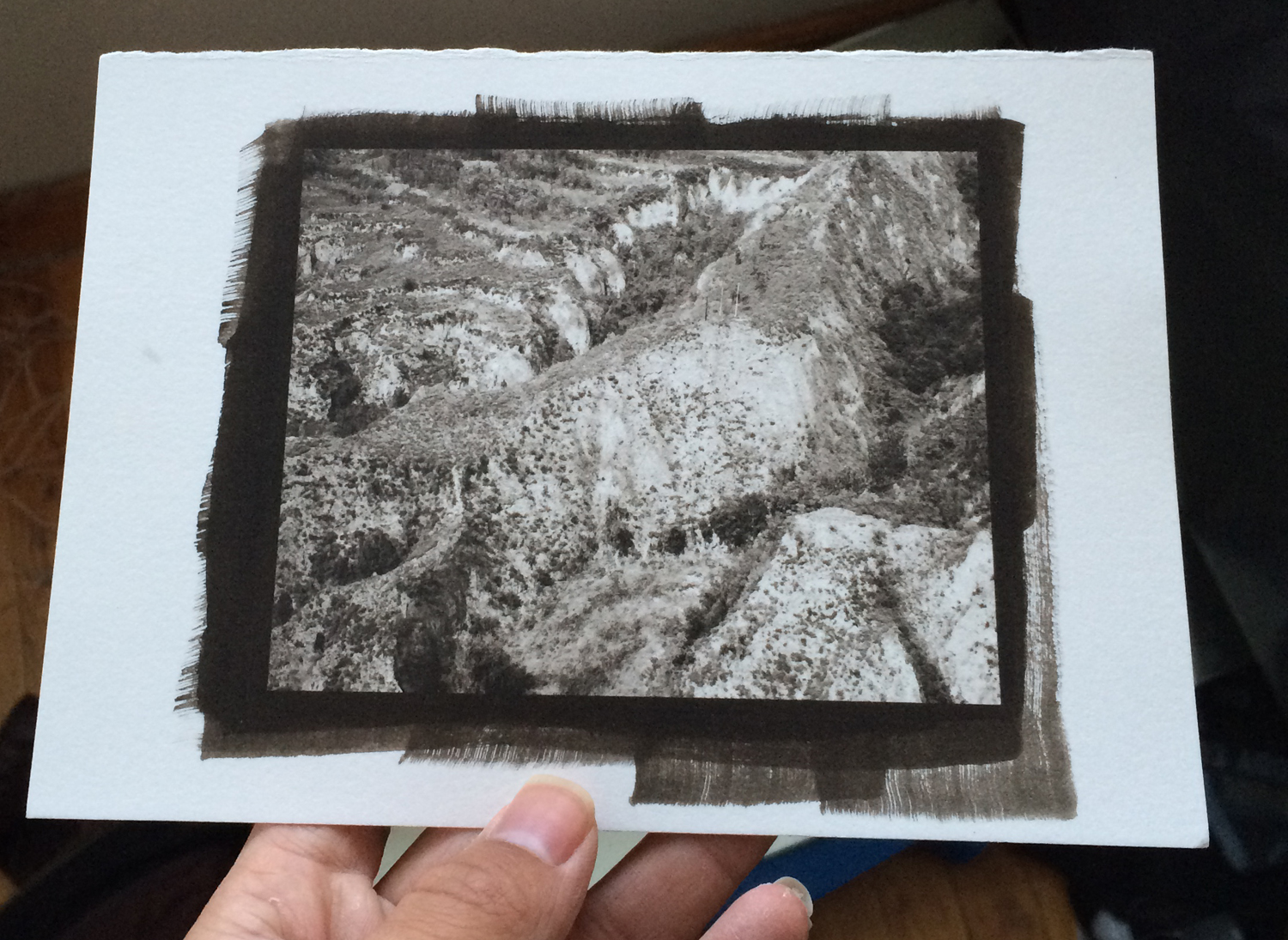

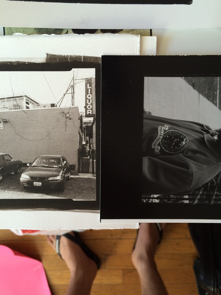

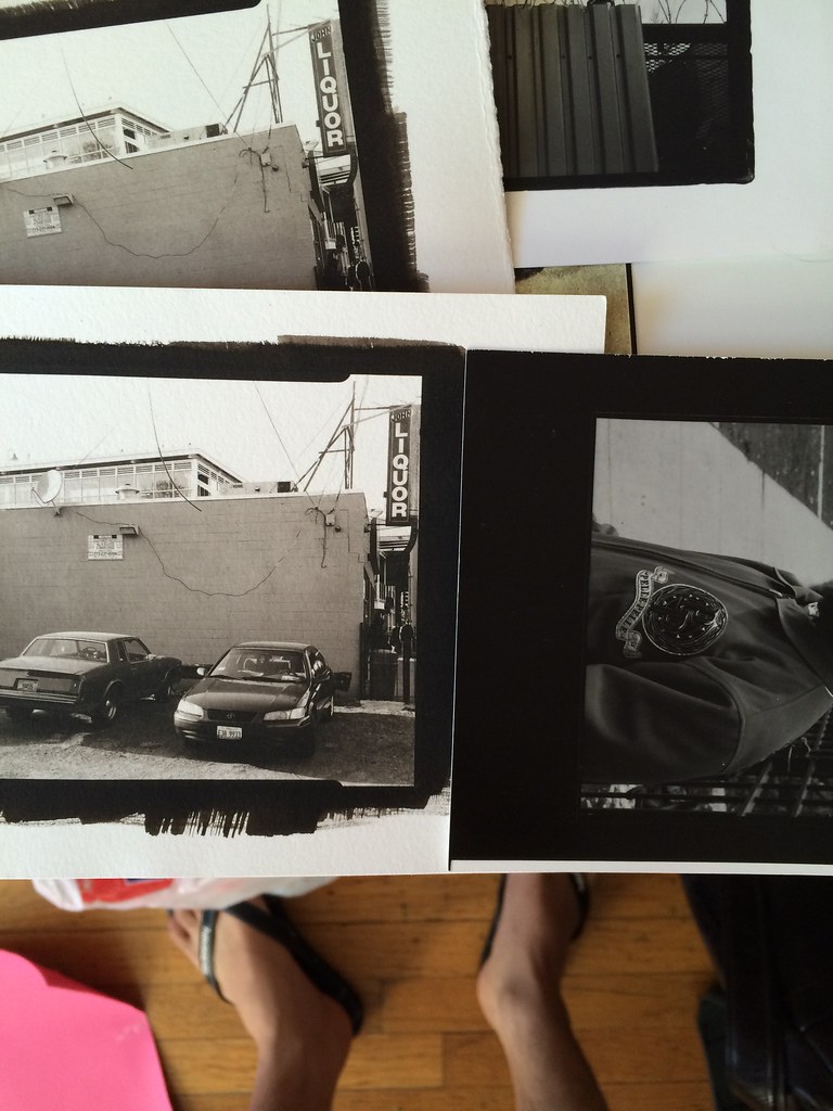

I am printing Na2 Pd on Arches platine. I find that i will get a speckle image without the help of tween20. however, the Dmax still weak even with tween20. i also have printed some prints on Hahnemuhle Platinum rag, the paper i got from my instructor. I can see differences in black area between two papers. the black on platine is brighter and warmer. The HPR shows a really deep black, which is what i assume that platine can produce. I wonder that am i get a bad batch of platine? from what i read that the platine should have similar max density as HPR.
I don't have a densitometer, so i could not determine the exact value of black.
my platine is from Freestyle. i use Ammonium citric as developer.
thanks!
the left is HPR, Ilford FB Classic on the right as comparison

This is how blacks looks like without Tween.

The left sandal looks colder than the right!:smile:

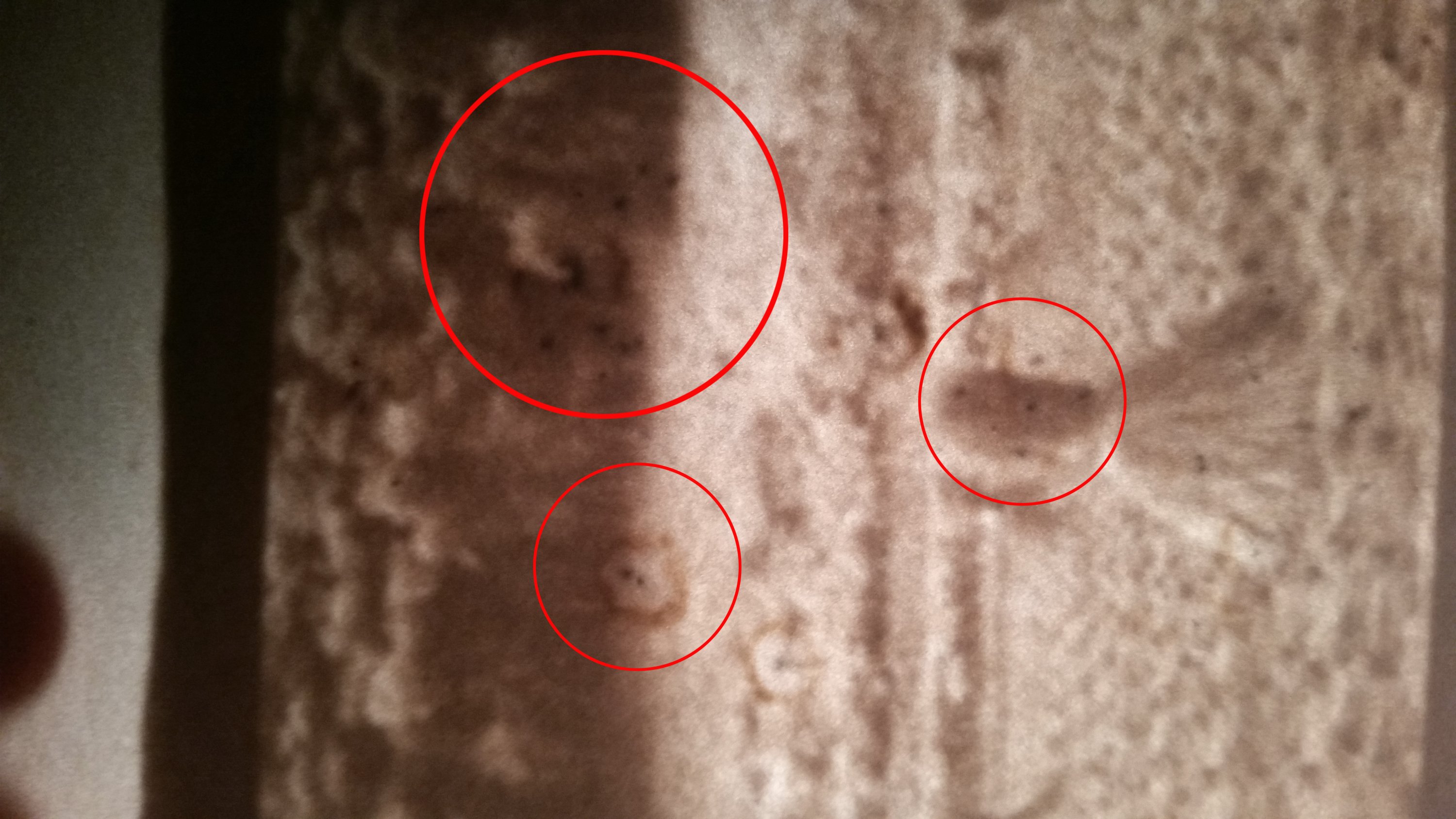

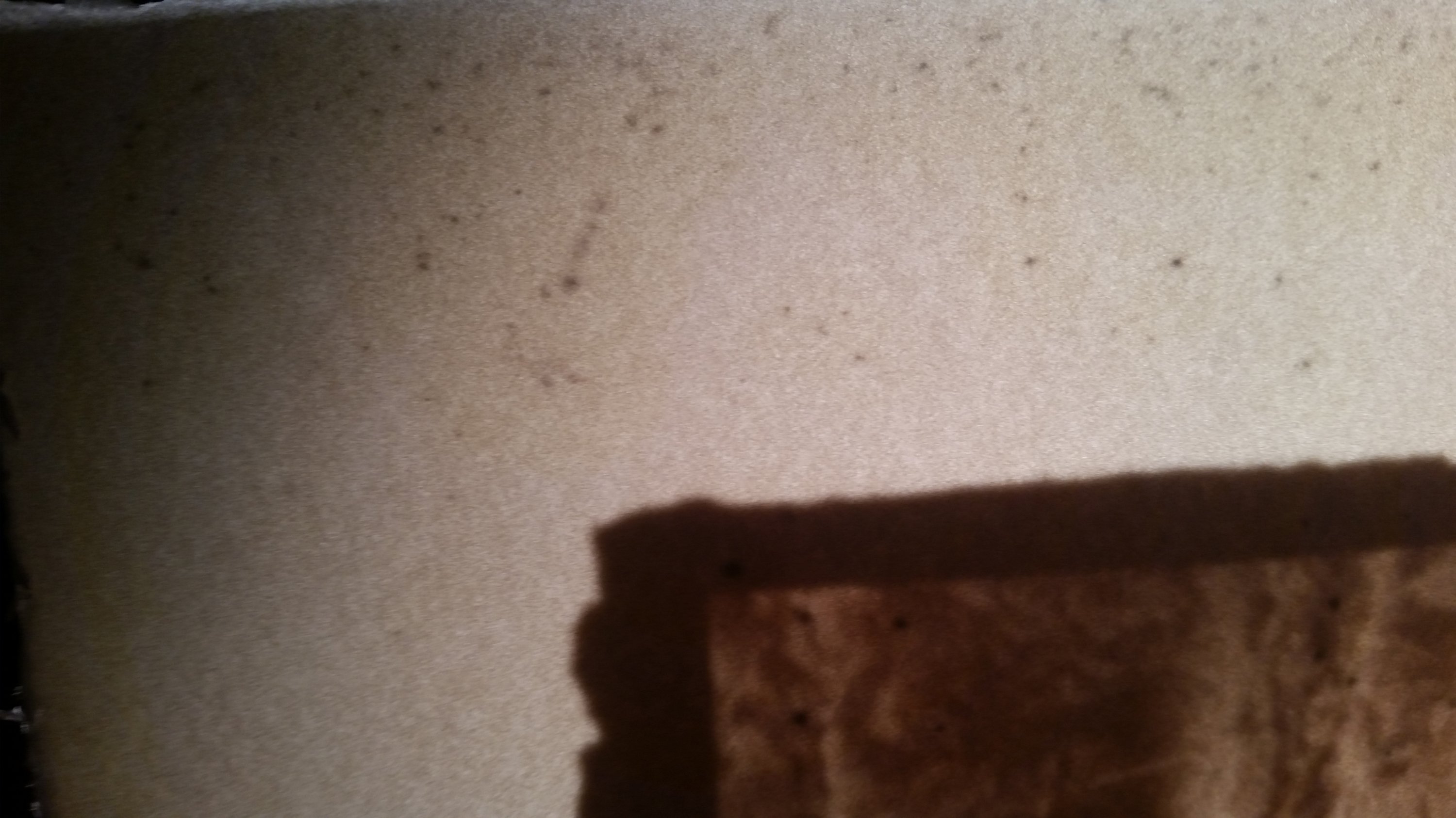

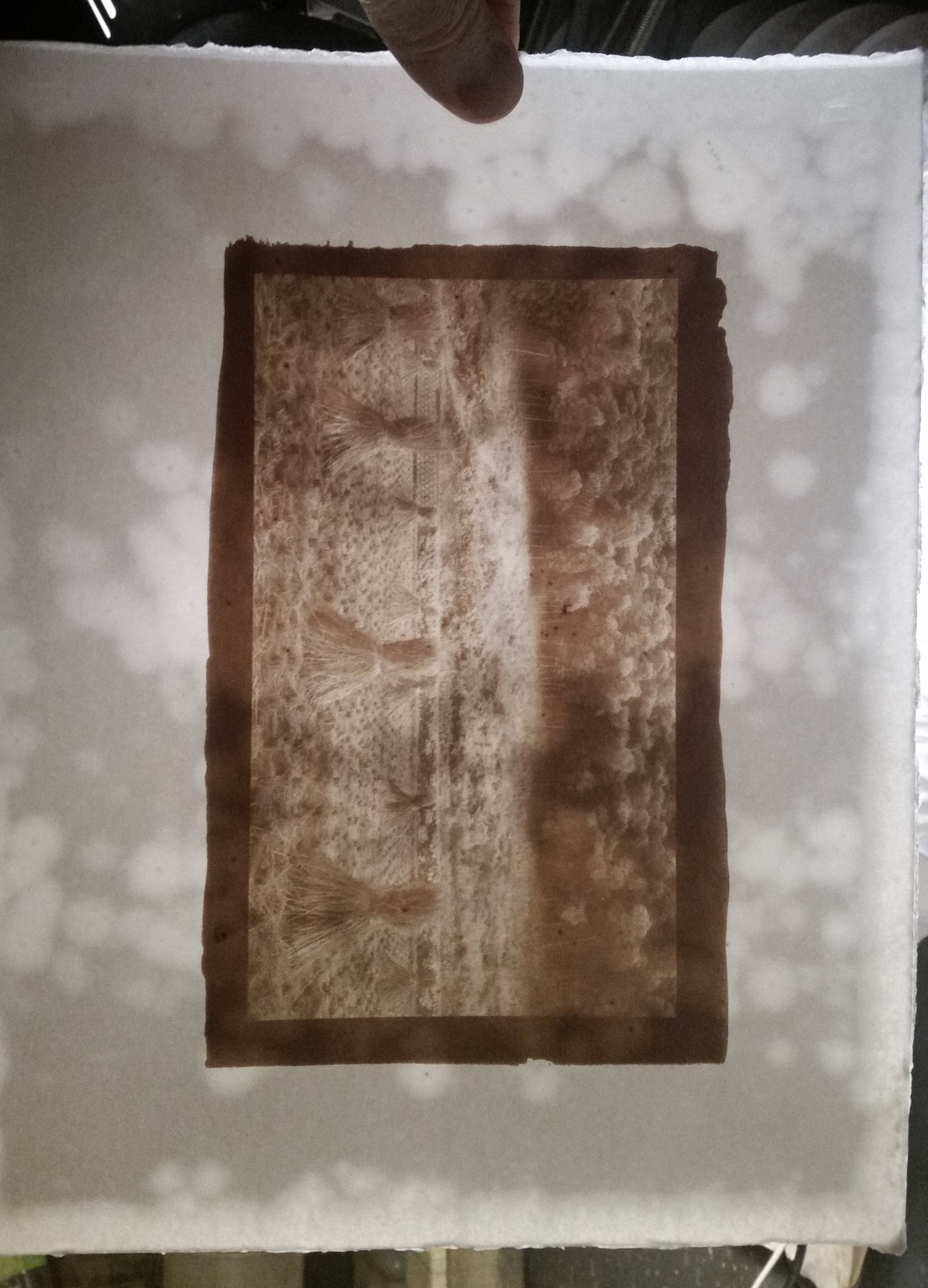

I picked up a sheet of Platine from an art store near me. During development (I'm making Kallitypes), it became quite spotty, just like the cheapy papers I tried in the past with suspect sizing. This looks like a sizing issue. Once dried, you can only see this defect when the print is back lit. Black specs can also been seen scattered about the paper when back lit. This is terrible. I contacted the art store and they are contacting their sales rep.

There have been numerous reports from all across the country in the last 6 months of alt process printers having problems with Arches Platine. They've either had a bad batch or made a production line change that makes it unsuitable now.
Yes. I'm well aware of that. It's a sizing issue. The art store I bought it from who just brought in a big new order however, was unaware. Unfortunately, they got a bad batch. I just ordered Hahnemühle Platinum Rag paper... 10 loonies per 22x30, is more reasonable.

No it's got nothing to do with how the sensitiser is applied or not dry enough. It's a sizing issue. You can see the spotty sizing when the print is immersed in the developer.... then darkened dots can be seen in a back lit print. Not nice. I've placed an order for 22x30 sheets of Hannamuhle Platinum.
