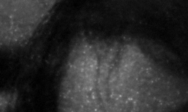

Hi all
Loving the new site
I developed some Ilford Pan F 50 shot on a Pentacon Six camera — developed Rodinal 1:19 5 min
I normally like the smooth look of this film and it came out rough with white spots.
Is this normal or am I doing something wrong. Should I be doing something differently?

Interestingly, all the reports seem to be about 120 Pan F, don't think I've seen any relating to 35mm. Anyway, I regard it as a problem inherent in the film that shows up under some conditions but not others.
Hi
Stop and fix are all the standard ilford products, stop still fine, colour hasn't turned' fix newish, thermometer used. I've dewveloped Pan F before in the same way I do this, other than it being Rodinal and 120 film, and never got this effect. Don't see how photo flo would prduce this

I'd write to Ilford with all the details you can and send it a sample negative. Let us know what it says in reply.

This is a common issue with Pan F+. How long of a time was there between shooting and developing? Also, has the film been stored in a humid environment?
Humidity-affected?
This is an excellent film for landscape work, and this is not something I have ever seen over about 20 rolls now since January 2016.
Pan F+ has serious issues with latent image degradation. My advice would be not to go longer than 1 month between shooting and processing. Really only a couple of weeks would be best. Ilford films in general are more sensitive to moisture than most others. Especially the medium format films with backing paper.
Mottling, spots and backing paper numbers showing up on the film are all the results of these problems.

As far as I know, Pan F is a very old emulsion. The film was introduced in 1948 at ASA 16 then increased to ASA 25 in 1956. After 1960 it became ASA 50 but I cannot determine that the emulsion actually changed but rather it was re-rated. I suspect that if Ilford altered the film to improve latent image stability this would upset a lot of fans of the film who would no doubt find that the film was not the same. Such a change could risk losing customers rather than gaining them. The need to develop it quickly after exposure is just a characteristic of the film.

This effect looks like it's caused by reused fixer. It's happened to me, micro particles sticking to the film, unable to be washed away by water and distilled water/Photo-flo bath. The problem went away when I discarded my reused fixer and used one-shot fixer, instead. I found that some films are more susceptible than others (e.g., Fujifilm Acros). If you can look at the film under powerful magnification while it's still wet. If you see micro particles (smaller than dust) floating on top of the film, it will give you the answer your seek.
