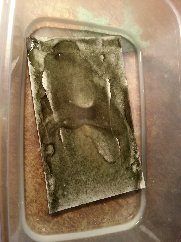

Dear photo enthusiasts,
I am a new member of your forum with a 'big' problem. After many years of practice in a darkroom (this includes the use of FOMA emulsion) I've decided to mix the emulsion myself. I followed a very simple recipe:
Solution A:
Gelatin 20g
Potassium bromide 16g
Distilled water 125ml
Solution B:
Silver nitrate 20g
Everything went well until I developed the first test print. It was going to be a simple photogram to find out how the coated paper works. Unfortunately, all I could get from that were edges of the object: the part of the image that was supposed to turn black came out as very mild grey.
I must add that I used 240 Bloom Pigskin Gelatin.
I went through many threads on this and different forums, but I couldn't find any place that mentions similar problem, or the very basic rules of emulsion making.
Is there anyone who has any idea what could have gone wrong during my process?
I apologize if this issue has been discussed already but I really couldn't find any information (simple enough) that could help.
Martina

OK, so the filter arrived and when I filtered new badge there was almost no residue at all. I was very careful about the process; I managed to keep the recommended temperature +-5 degree. I applied 5 layers however, the results are still the same. As you can see in the image it looks quite awful. I am aware about the inconsistency but it isn't my biggest issue at the moment. What worries me is that I can't get any black at all. Cliveh and Wildbillbugman mentioned that I should use a different developer, but I am not sure if this is going to solve the problem.
Does a light fogged sample developed in Dektol straight get black?
If so, then the addition time must be too slow, if not, then there is a problem with the formula. I'll look it over again.
PE
