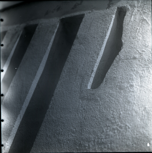

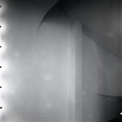

Sorry for huge delay...
meantime I succeded to scan some of the negatives I was talking about.
Here they are.
Thank you
I'd get a better tank, it looks like it's causing the problems and a new one will be far less expensive than ruined films in the long run.
