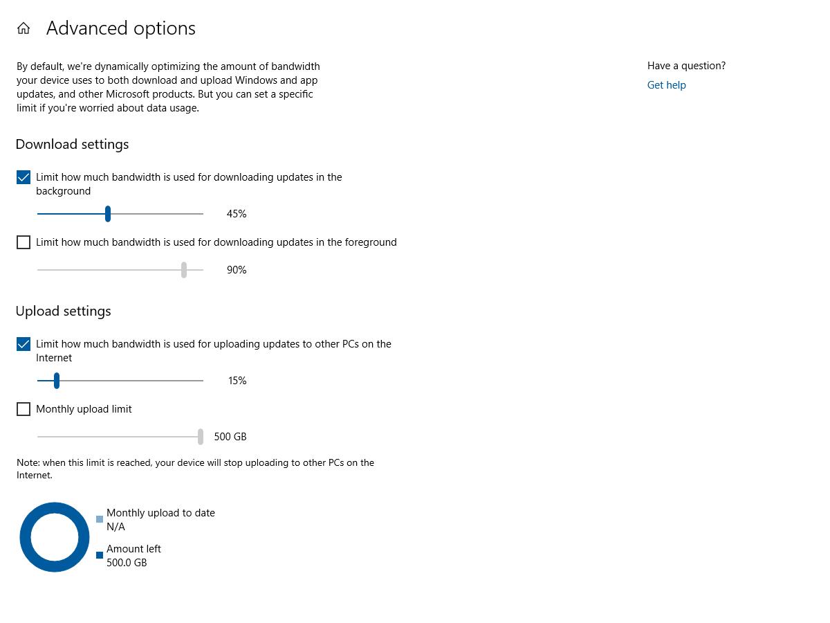

In the Update & Security section of Settings click on the Advanced Options/Delivery Optimization until you get to this screen:
ScreenShot_20181020125428.jpeg then select and adjust for your system/usage. Review the settings on each page as they may improve your experience also.
