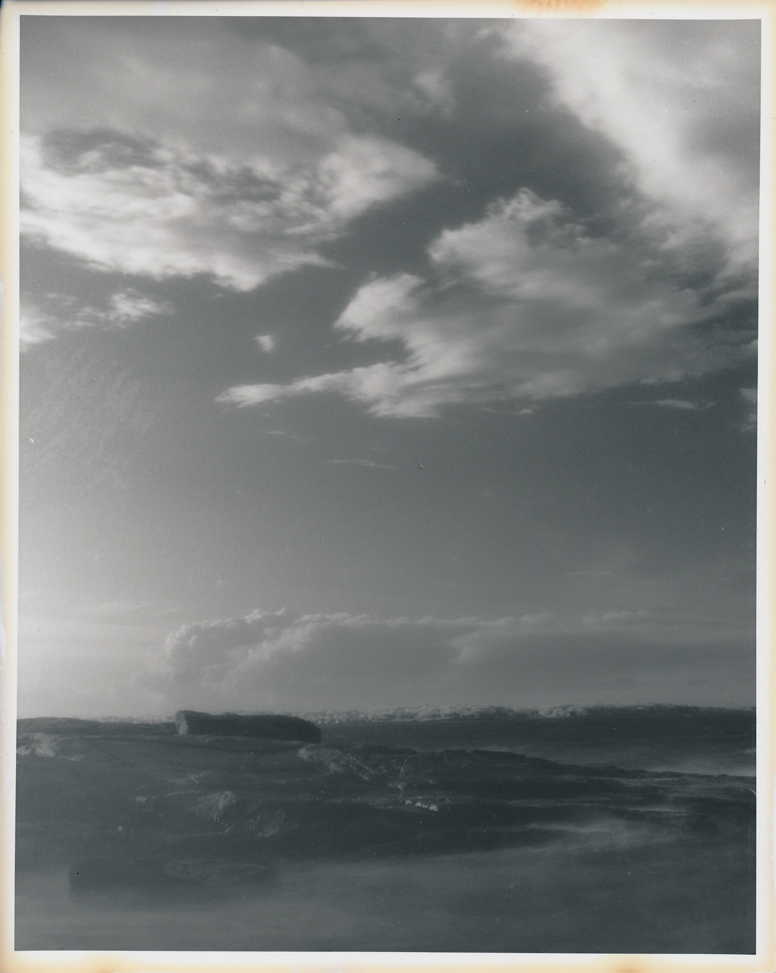

I just made a bunch of prints last night and this morning I took them out of the darkroom. When I got home from work they all had turned a brownish color. I was using LPD developer and TF-4 fixer. I've not had this problem before. What could be the cause? I have check my safelight. I was using Ilford RC pearl paper. I'm thinking maybe the fixer was bad? I followed the instructions and fixed for 1 min with constant agitation.

I could see that if it was just in a spot or two but this is along the whole edge. I've attached a test print I did that shows it. I know the print isn't the best but I was trying to print a difficult negative. I finally got it but this one illustrates the problem better.
You can see it along the whole bottom edge along with other places.

The browning is only in the boarder with the exception of one print and that one has a brown spot near the top. The highlights are nice and white and I can't find any other discoloration in the prints.
Hi, I wonder if you're not agitating enough in the fixer, and the discolored borders are a result of the sides curling up slightly, so that they are nearly out of the fixer?

One further possibility.
RC paper is subject to delamination around the edges if you are particularly rough with it and/or you over-wash it.

Even 30 minutes probably isn't enough to always seriously damage RC prints. Check the corners and edges of your prints - if they are frayed and appear to have separated into layers, then water and chemicals can go where they are not supposed to be.
