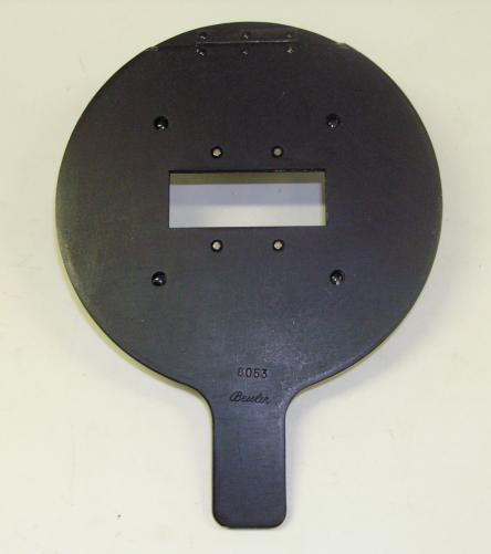

I had an Xpan negative carrier made for my Beseler 23C. I sent SK Grimes a regular 35mm carries (24x36mm) and they machined it out to 24x56mm:
