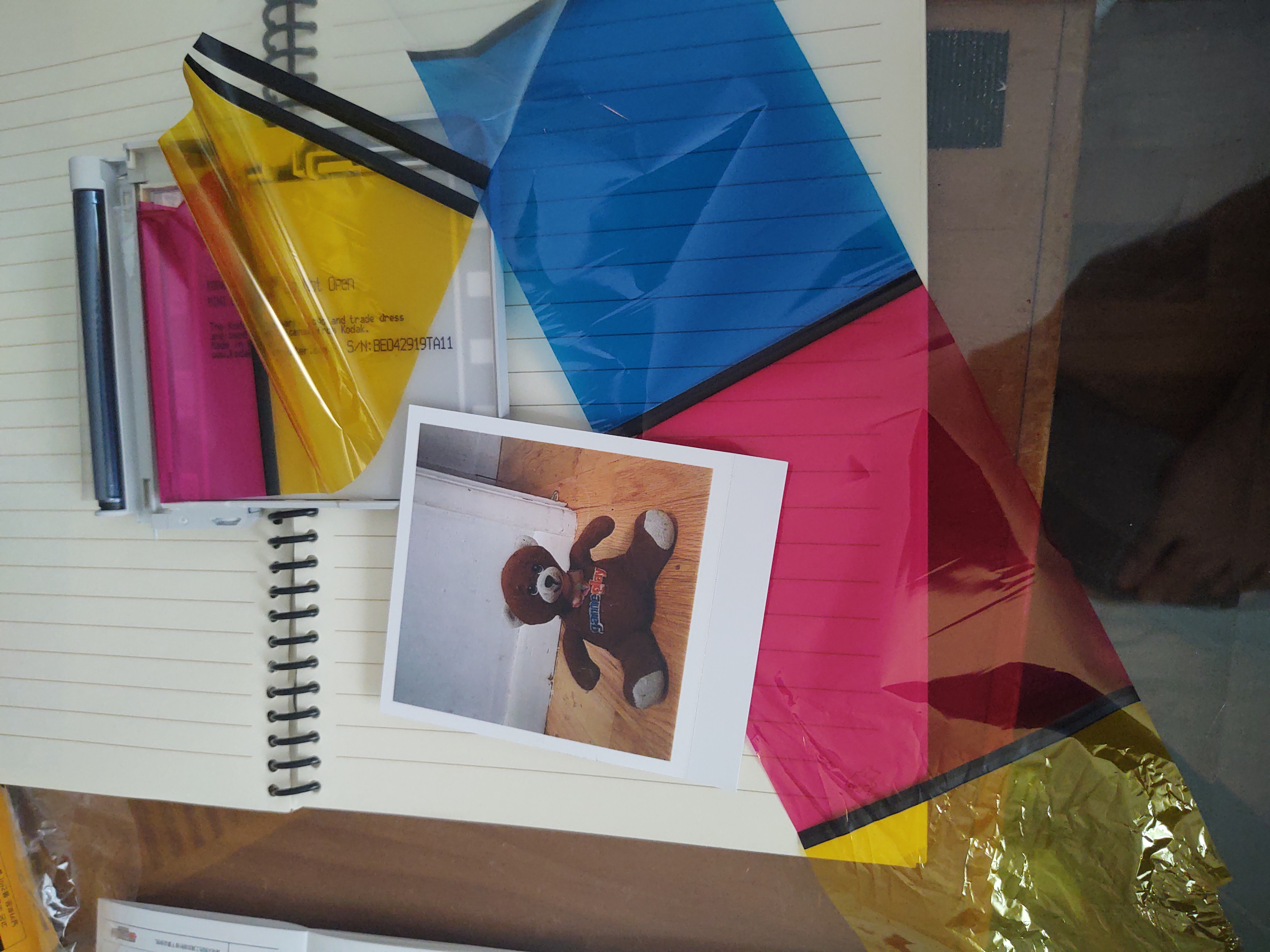

Okay, I got the kodak 4 pass printer. Not sure if this is Zink or some sort of hybrid. They appear to have a selophane roll of different colors, the film is heat laminated on to the paper, yellow, magenta, cyan, clear. The plastic has black sections to control the position of the roll.
The images are 300dpi and look like a print from an old inkjet printer. Its borderline disapointingly good enough.

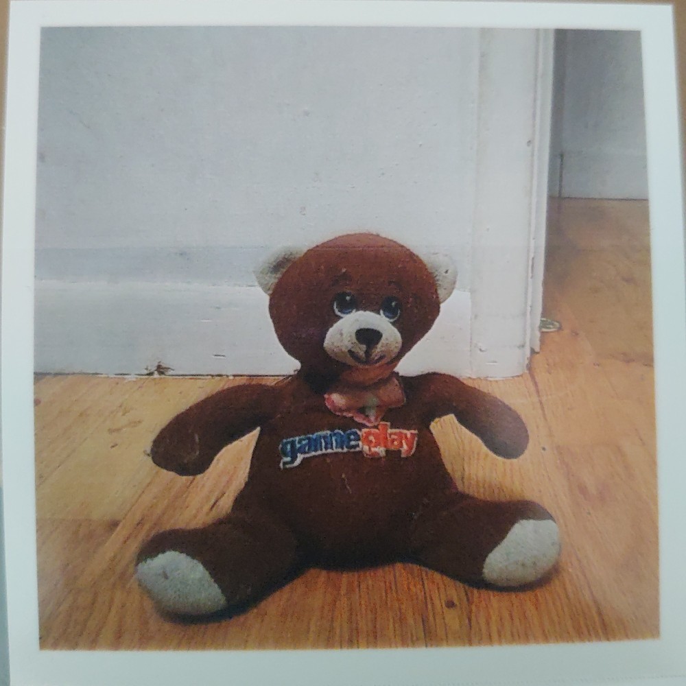

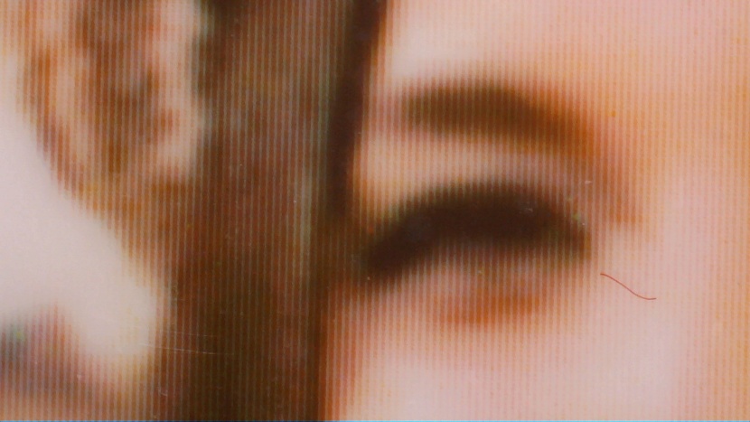

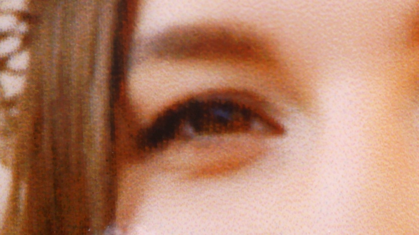

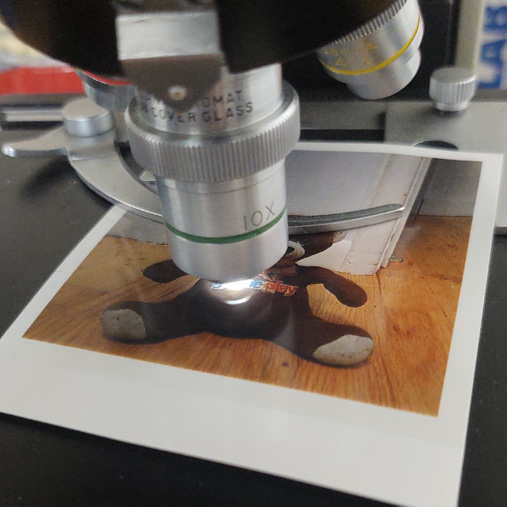

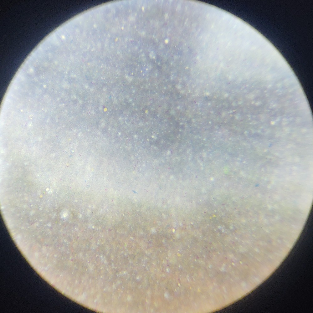

Anyway this bear photo was taken on the kodak by my little girl and as I said it looks acceptable just don't look up close if you got myopia or use a lupe because thats disappointingly bad. Here's the photo and a look using a 10x with 20x eye pieces so 30x.

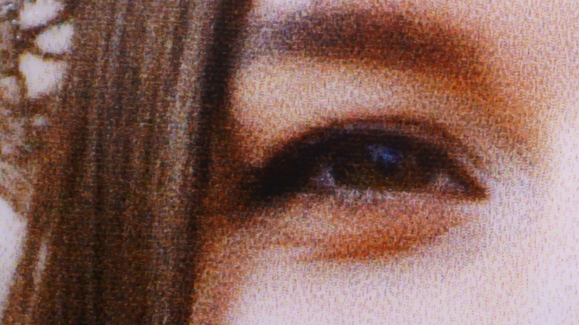

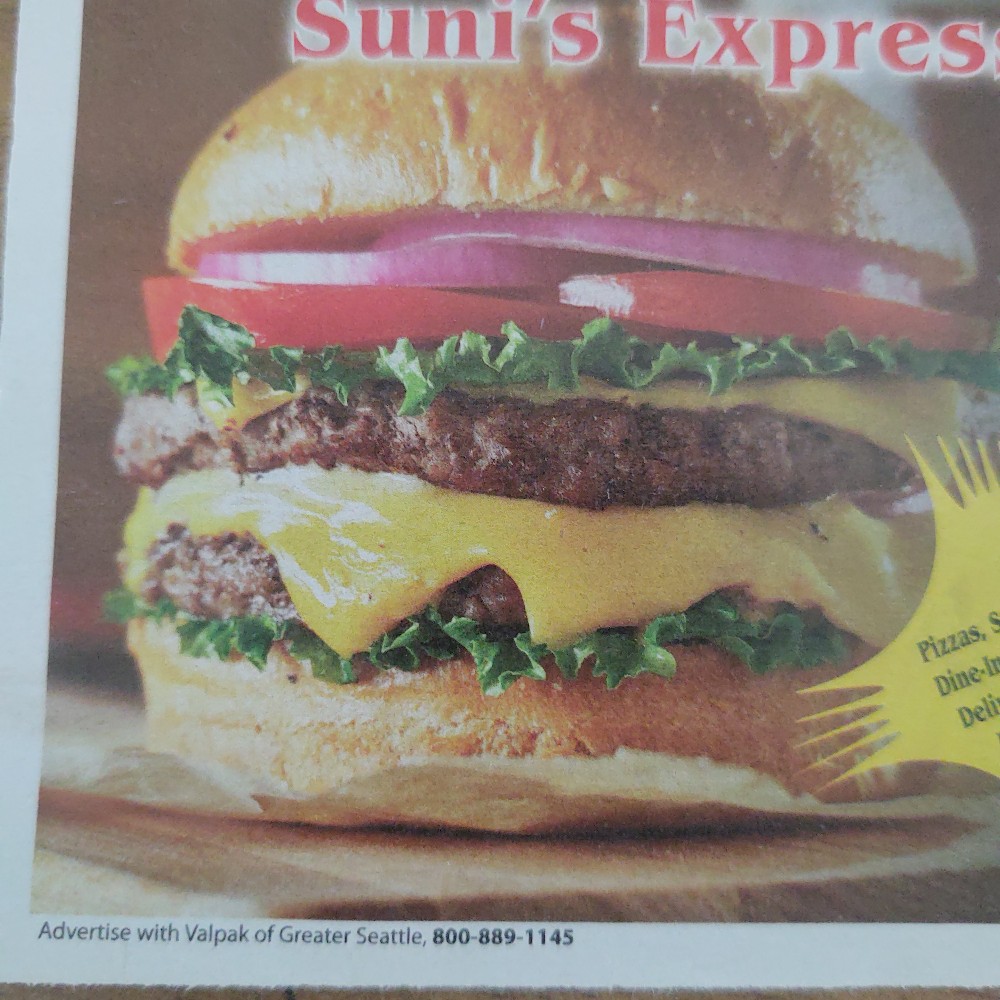

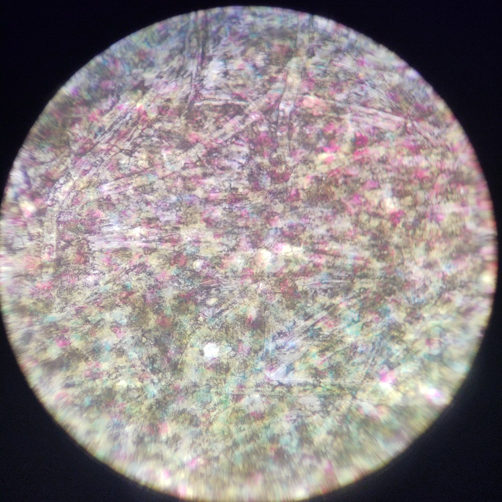

Here's a very comparable news paper print of a delicious burger and a 30x zoom into the lettuce where you can see the individual ink dots. I imagined most of us have news paper ads to take a look and compare. Sorry kodak but someone had to.
