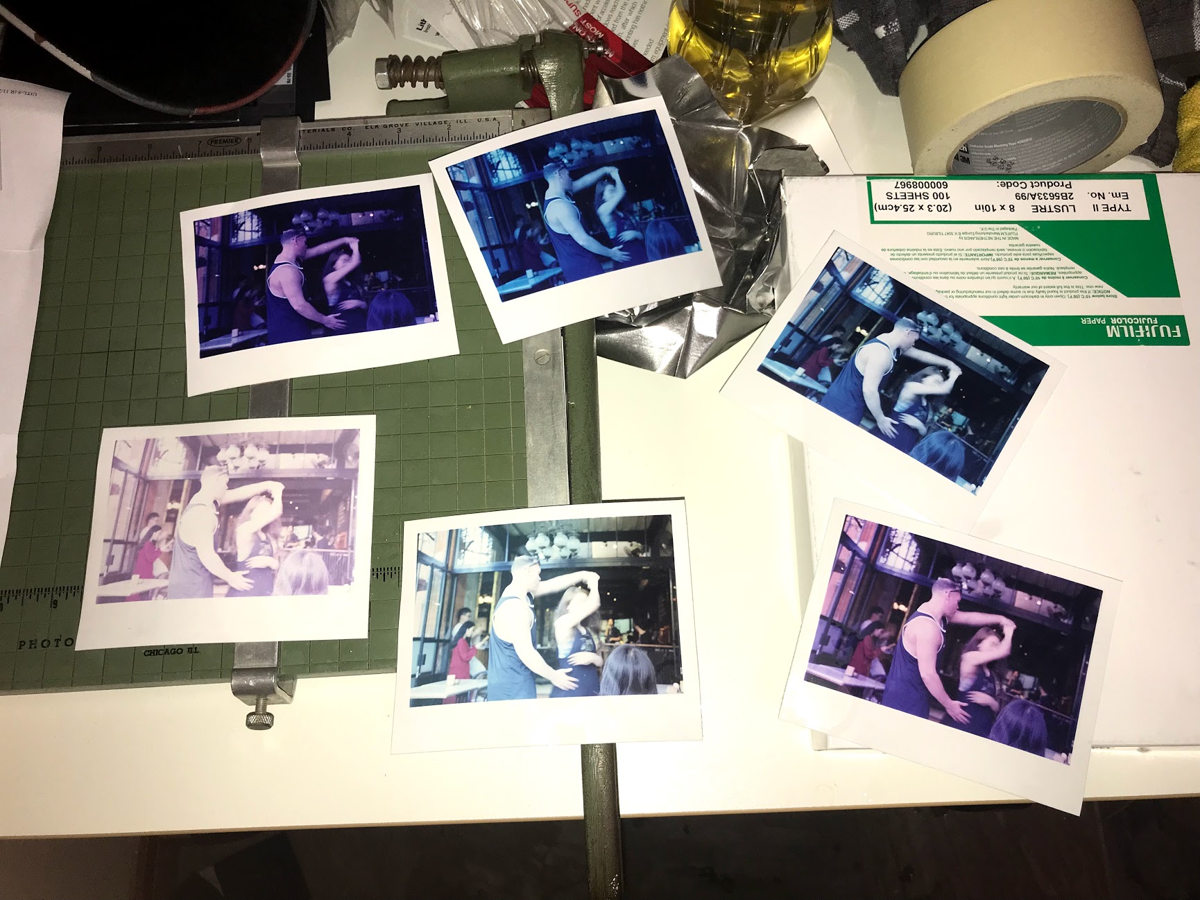

I had a trial run at this last night by cutting 2 sheets of 8x10 in quarters and using a tiny 5x7 tray with just enough developer and blix to cover the paper (didn't have much time for printing, so knew I wouldn't be able to make much more than 8 sheets).
The results are not awful, but definitely not proper color balance yet. My best (bottom right) was printed (in R/G/B) 4/9/6 at f/11 and with the enlarger very close (4x5 paper). And second best I think for color though way too light (bottom middle) was printed at 2/2/4 at f/11.
Trying to figure out how to correct casts is definitely not trivial. Does anyone know of any guidelines or other instruction on proper adjustment for each color of cast? I stared at a color wheel for a while last night and wrote down some guesses, but not sure if they're right.
