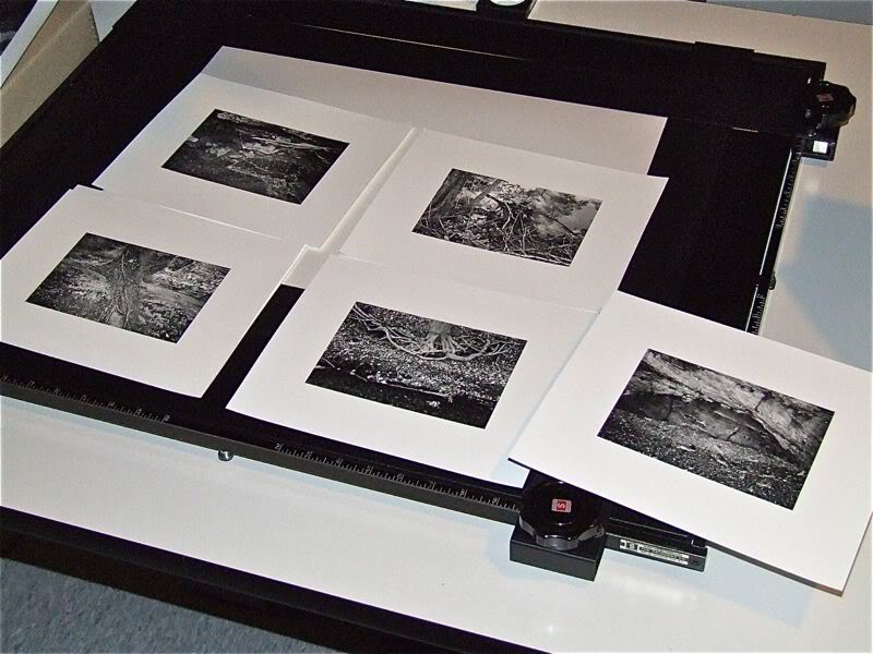

All my 4 blade easels allow small images on 8x10 paper (even the 20x24" shown). With 35mm film I usually use an 80mm Componon-s.
