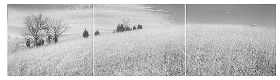

Hi.
I exactly cut the negs (ouch!), glued them with sticky tape on glas (with little space between) and made contact prints. On top of the glass, to prevent the paper gets full black at the borders, l I put a cardboard with cutting an exact hole for good borders.
I will first send it to the postcard exchange members, then show it in the gallery.
I am not sure to do this type of "art" again. It was a lot of work. But on the other hand it made fun, too.

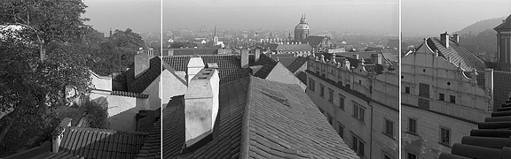

I have done a lot of this over the last 20 years from 4x5, Rollei, and 35mm. I have tried many ways to conceal or mask the "joins" and have never been able to completely because of slight differences between negs (the clouds don't stay still). To me, I accept the join and print each image on a separate piece of paper, cutting and joining when mounting. I leave a very small space if drymounting (maybe 2mm) and a small section of overmatte between windows if not drymounting. I like the clean formality of the look, the space being accepted and recognized as a part of the process.
Two samples attached - the Prague shot was actually hand-held 35mm with a 28mm PC lens. The White Hill was 3 4x5 negs shot horizontally, nearly full frame.

Very nice work, and you notice he is not concerned with perfect "joins", even has some parts of a panel appearing in the next panel where individual images overlap. I think (to the original question in the thread) that the idea is to find to total "recipe" of treatments and choices which best supports your images (intended and photographed), try different things, look, and feel the results. Meanwhile, enjoy and learn.
