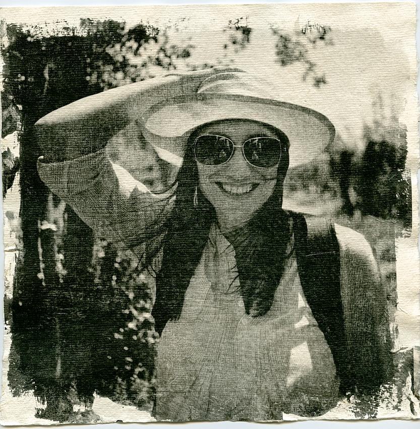

Looking at that picture I would also consider printing on another medium such as liquid emulsion on hand-made paper. This can make for an interesting effect where the texture of the print negates any spots :smile:

Thanks, Ghostman - is liquid emulsion the same as hand-coated paper?

you can buy photographic emulsion, for example the Rollei/AGFA Maco liquid emulsion. It's variable contrast too. You can coat all manner of surfaces from paper to glass. Buy a nice piece of paper, watercolour papers for example, acid free if you can get it. In the darkroom, melt a little of the emulsion at a time in a Bain Marie (double water bath) and paint the emulsion onto the paper. Let it dry and then use it as you would.
The beautiful thing about hand-coating papers this way is that you choose the paper so you can choose the texture. The paint strokes are seldom perfect, but that's part of the charm.
So, if you have a damaged negative, why not make the printing of it a serendipitous thing altogether :smile:
Have fun printing.
