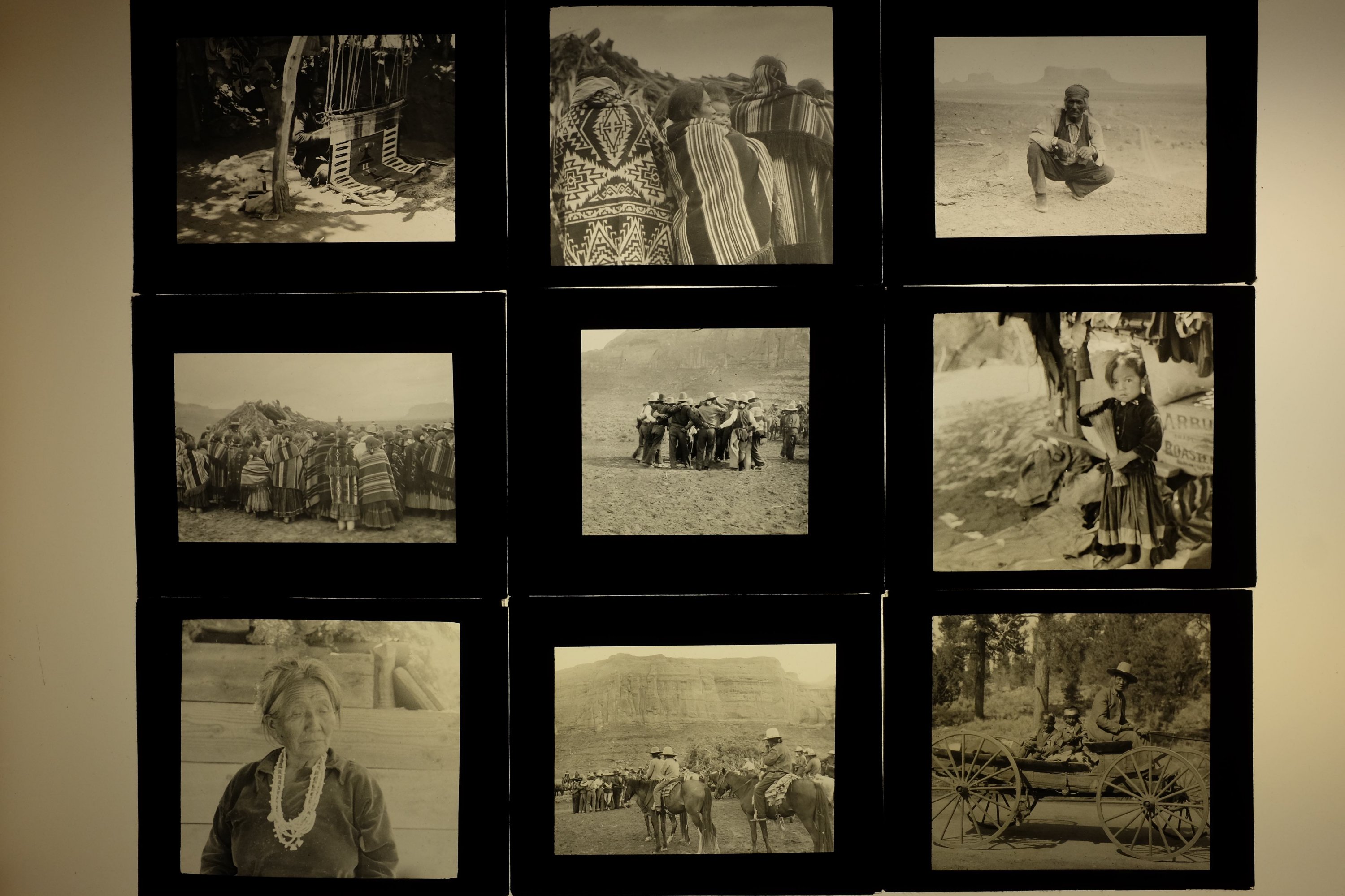

Hello all,
I'm wondering if anyone has advice for making prints from old positive slides (I have many boxes of my great-great-grandfather's Kodak Lantern slides) in the darkroom. From the little research I have done, it seems that Harman's Direct Positive paper will be my best bet. I have read a little, here on APUG and elsewhere, about 'pre-flashing' techniques to control contrast but I'm hoping that somebody here may be willing to share their personal experiences printing from slides or from Harman's paper.
Thanks very much for your help!

The samples you posted are very cool!
What if you did contact prints onto sheet film? Then just enlarge those onto regular paper? I would think cost would be a wash or slightly better than Harman Direct?
