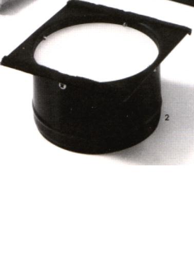

Grae,
Are you using condensors, or is there something inside the lamphouse that looks like the attached "jpg".
If you do have something that looks like that, then you are using "diffusion mode" The attached pix is a diffusion unit that replaced the condensors. The pix is a diffuser for medium format (both the top and bottom of the unit have a large frosted cover).
If you are getting a circular image, it sounds like the diffusor is for 35mm, one side will have a large white cover and the other side will have a much smaller circular white opal cover.
The model that I have is the 23CII XL and I switch back and forth between diffusion and condensors. If you have the older 23C "I think" you could likewise switch between them.
My suggestion, look inside the lamphouse, (push down the upper bellows and disengage it from the condensor assembly) and see if you have condensors or diffusers.
Hope this helps
