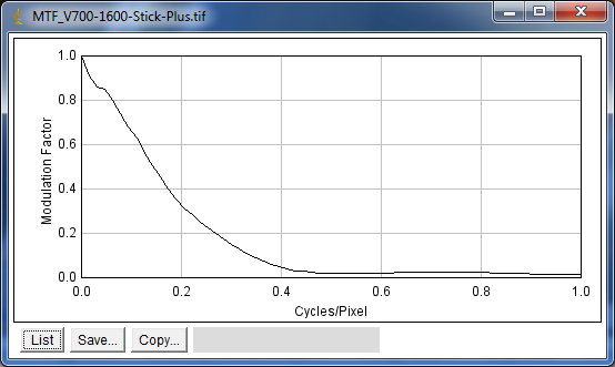

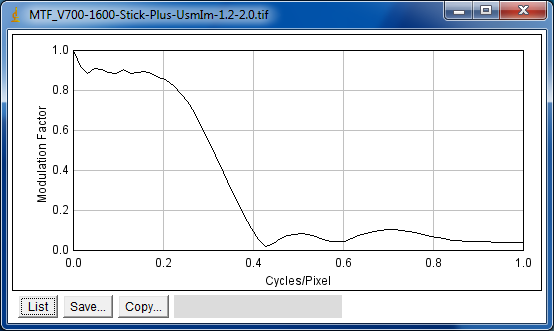

3 - "Resolution" in scanner specs or tests usually means the highest lpi (2x, actually) where the stripes are still discernible. In technical terms, this means scanner resolution is defined at vanishing MTF. Which is not very meaningful. Below some MTF plots from tests of my V700 10 years ago. Not in the 4000dpi ball park, but just to illustrate the principle.
Straight from scanner:
With the "best" parameters for MTF restoration using Gaussian USM:
In both cases, the MTF drops to zero just beyond 0.4 cycle/pixel. But the boost in MTF at 0.3 cycle/pixel, from ~0.17 to ~0.55, makes a large difference in perceived (sharpness, resolution, whatever, I'm not here for semantics).
Please note that the kind of MTF restoration I'm proposing is much less than what I sometimes see online or in shows, that just hurt the eyes. On occasion, I've brought this up to the photographer, that either admits sheepishly having sharpened maybe a little too much, or takes a stand and claims that's how he likes his pics.

Out of interest, what is the reason for the dip at .6 cycle/pixel in the sharpened example?
@bernard_L thanks for the insightful reply.
  1. Spatial frequencies beyond 0.5 cycle/pixel, in actual use, "do not exist". More precisely, they are aliased onto the frequency that is symmetrical wrt 0.5 cycle/pixel. Remember grain aliasing, buzz word occasionally found on internet discussions.
  2. How then will you ask, can the plots display frequencies beyond 0.5 cycle/pixel. Because of the trick of slant edge MTF measurement, not applicable in general image scanning. Google it...
  3. The actual V700 hardware+firmware is a bit complex (staggered rows of sensors) and must be treated as a black box. Short answer: I don't know.
