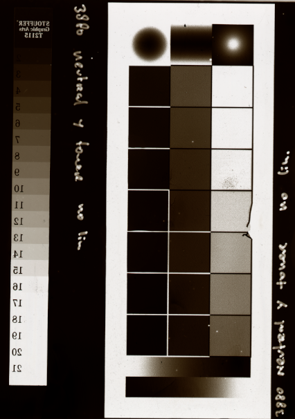

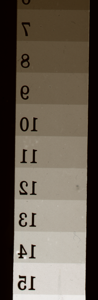

Here's a snippet from a carbon transfer step tablet test; it's an imperfect transfer onto glass (note the broken line on the right), but it demonstrates the problem IMO.
The Stouffer step tablet to the left is a silver gelatin negative, basically. The 3-column step tablet to the right is a DIY one inkjet printed on my Epson 3880 using the MK, LK and Y channels (it's not linearized). You can already see the coarseness in the mid-grey steps in the bottom half of the rightmost column.

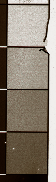

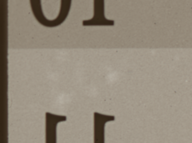

Here's a closer look at that bit:
Note that this also has banding and that the rendering is rather coarse. By comparison, this is a section from the Stouffer tablet at the same magnification:

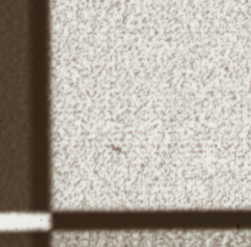

This is a 100% crop from a 2400dpi scan of the same image above:
You can actually count the individual inkjet dots (which, in fact, is the root cause of the whole problem to begin with...). The slight fuzziness is mostly due to the flatbed scanner and a very slight contact problem when making this print because I was sandwiching two overlapping negatives on top of each other, which degraded the contact between the carbon tissue and the negative a bit. In this section it's not so bad though.
Compare to a section of the Stouffer at the same magnification:
If you look closely, you see a slight dot-like modulation, which in fact is the mushy way the scanner renders the film grain on the Stouffer step wedge...if I take a good loupe to this plate, the grain actually renders quite sharply. But...film grain is truly stochastic, so it doesn't create the kind of banding problems you'll often run into with inkjet negatives.

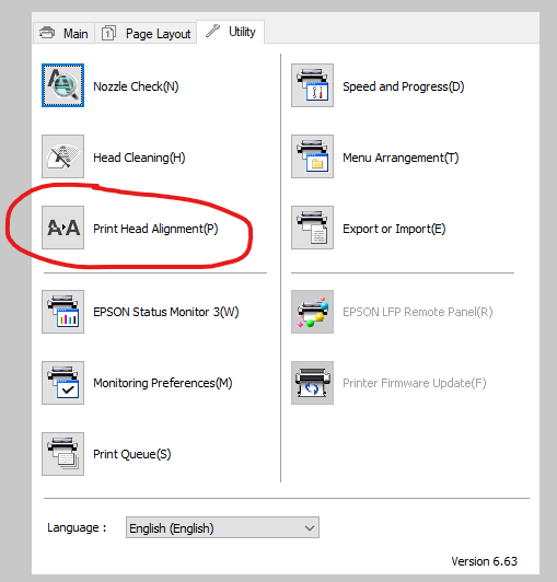

When I get banding, I do a head alignment, and Bob's your uncle.
Yeah, it's worth a try. On my old 3880 in Windows it's in the printer settings dialog:
However, when I tried this while battling striping/banding issues, it never made a difference. Alignment was always 'optimal' already.

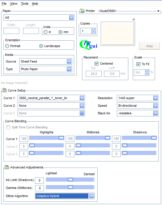

In QTR, for digital negatives, I usually print at 1440dpi and use bi-directional printing. Try one-directional printing to see if it helps with the banding; it may make a slight difference. I never found any benefit in printing at 2880 dpi; it changes the dither pattern a little, but it doesn't get any better, nor do you get more detail. It does deposit more ink this way, so it'll affect whatever compensation curve you'll need to make. The gist is: use one resolution setting and stick with it. Here's what my typical QTR dialog looks like:
It doesn't show the actual compensation curve, but that's a different matter.

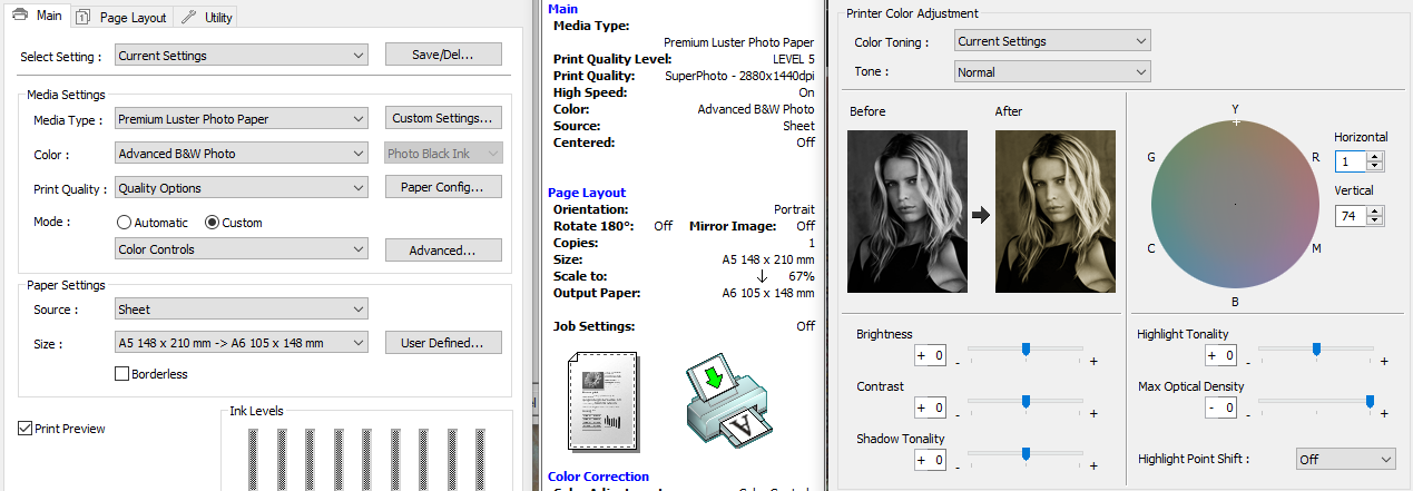

In the Epson print dialog, my settings may look something like this, if using Photo black:
Note the 'toning' option which basically creates a B&W print that also uses the Yellow channel for additional blocking power.
If you want to use the Matte ink, just select a Matte paper, like Enhanced Matte or Archival Matte.

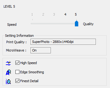

My "quality options" dialog usually looks something like this:
You could juggle with the options a bit. There's usually not much quality difference between them.
* High speed is the bidirectional option; it determines whether the print head only prints when traveling in one direction, or if it prints while traveling in both directions. The latter is faster, but can introduce slight alignment issues. However, it will in general not cause the kind of banding you describe and I've always found the difference irrelevant.
* Edge Smoothing and Finest Detail are algorithm options that affect the dither pattern. You can play with them to optimize your negatives, but again, I don't expect either will remove the banding.
The Alignment option @Andrew O'Neill mentioned is the only one really worthwhile spending any time on, but as I said, it didn't help in my case. There are hardware tolerance limits for these printers and their parts, and they are sufficient for normal printing on regular paper, but we're pushing things way over the limit with our digital negatives. These printers were never made for this kind of thing, so it's a bit of a kludge in all honesty.
