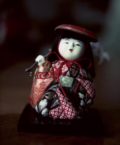

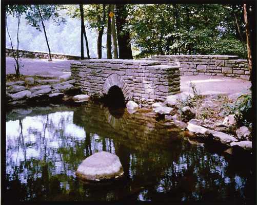

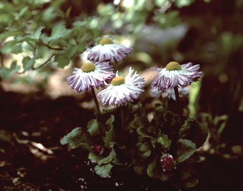

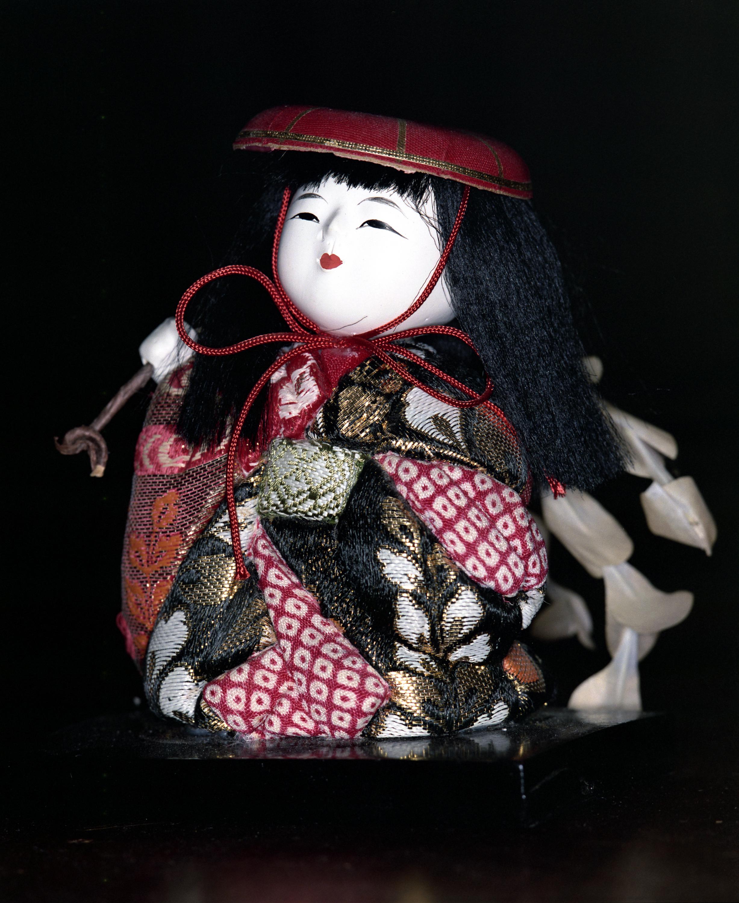

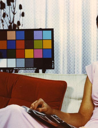

Hint hint? Some of these are already in my gallery guys.
Little doll #1 is a cross process and little doll #2 is a direct scan from the negative. The popup names are self explanatory though! These are slides printed onto Endura, or cross processed Ektachrome printed onto Endura.
