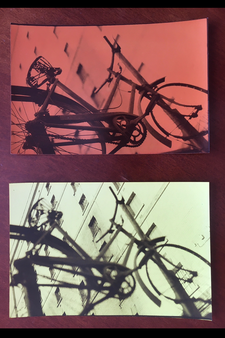

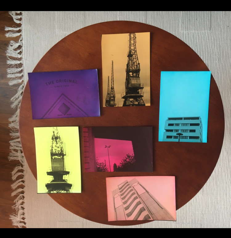

Many thanks! I’ll have a look at it! If I find the printer then I want to tone them with food colouring and vinegar and also coffee. I’ve done it many times and they look great!
Hmmm... sounds interesting! Can you provide any details of your method?
To my way of thinking (and obviously with seeing any examples) this sound more like you are staining the paper and not truly toning the image. Toning an image, to me, is shifting the tone of the greys and blacks. I.e. you are affecting the image not the paper it is printed on.
Either way, I'd be interested in seeing examples and/or hearing the details.
As for printing on paper that is not specifically treated for inkjet printing, I do this regularly on both watercolor paper and printmaking paper... one of my favorites for this is Arches Johannot, specifically because of its unique texture. I also often use smoother papers as well.
I have used the advanced black and white (ABW) mode with an Epson 3880 and a P800 for this sort of printing, using Epson inks. I also use the Piezography Pro system with an Epson 3380 for this type of work. Both systems work well. The Piezography system gives one much more control over the toning of print, especially if you want to do split toning. (Before setting up the Piezo Pro system, I used an old Epson 1440 with their warm neutral inks for this type of work.)
Another method your might like to experiment with is hand-coloring your inkjet prints. In this post (https://www.photrio.com/forum/threads/hand-colored-inkjet-print.179779/) I show a hand colored print made with Piezography inks on Hahn. Biblio paper. There are more examples of this on my website, see: http://gorga.org/blog/?s=hand-colored
Another "non photo" paper that can work beautifully (with exploration and practice) is "rice paper" ....in fact MOAB and some others make that sort of paper specifically for inkjet printing.
Rice paper! I totally forgot about it. Thanks for raising my awareness!
Yes, you’re right, it’s rather staining the paper than toning the subjects of the photo.
I use food colouring what you can find in any supermarket.
As with vinegar I use cider vinegar and white vinegar. White vinegar is better if you don’t want the vinegar to take any colouring effect. The coffee is the cheapest powder coffee what you can get. I use it only if I want to boost the orange or brownish stain.
The mixing is quite improvised, I just go with my gut feelings and check the colours by eye and continuously keep in mind that the vinegar will dilute the colours so I always mix a deeper tone.
Without the vinegar and/or coffee the food colouring doesn’t do too much only a bit of layer, I just tried it once how it goes but from the first attempt I always added vinegar and/or coffee depending the colour I want to get. It needs the acid to be able to soak in deeper in the paper’s tissue.
What was suprising to me was this mixture’s ability to keep the colours for a long time. Okay I don’t know for how long will they last but I’ve done these examples for more than a year ago and none of them were faded not even one bit.
When I finally ready with the mix I add water to it. This is also a factor when mixing the colours. I usually add only a few splash as it’s better to avoid diluting the mix. The water is hot, I wait a few minutes after boiling. I never tried boiling the vinegar and adding it straight to the mix though I should and I will at the next staining.
The hotter this mix is the earlier the effect takes on the paper but still needs a few minutes. My observation was that there’s no need to leave the paper in the mix for longer as it won’t do too much afterwards and if yes the paper will begin to molder especially at the sides, unless one want to achieve this effect.
Before I place the paper I mix the mix well avoiding the knots to be formed as it can ruin the smooth look though it can also have an interesting effect if that’s the goal.
If I find the right printer I then have to experiment with watercolour paper as it will react a different way in terms of how it soaks in this mixture and how it will react and keep the colour and so on.
I’ve checked the printers and papers you suggested and well worth to think about them, so thank you indeed! Also the hand colouring is something I might consider doing.

Laci,
Thanks for the info.
The examples you posted are very nice.
They remind me of an experiment I did about a decade ago, before I retired. For some reason, we had a bunch of colored (mostly pastels, if I remember correctly) copier paper in the office. I printed a few photos on some of this paper just to see how they would look, but I did not try anything serious. Cheap copier paper is too far from archival to put much effort into and I never thought to try finding something better.
Now, I'll have do put prints with colored paper (by whatever method) on my experiments to do list. Thanks for the idea!
