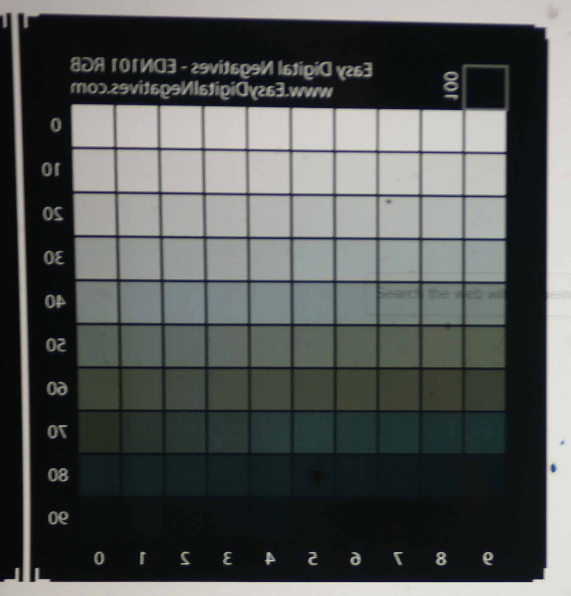

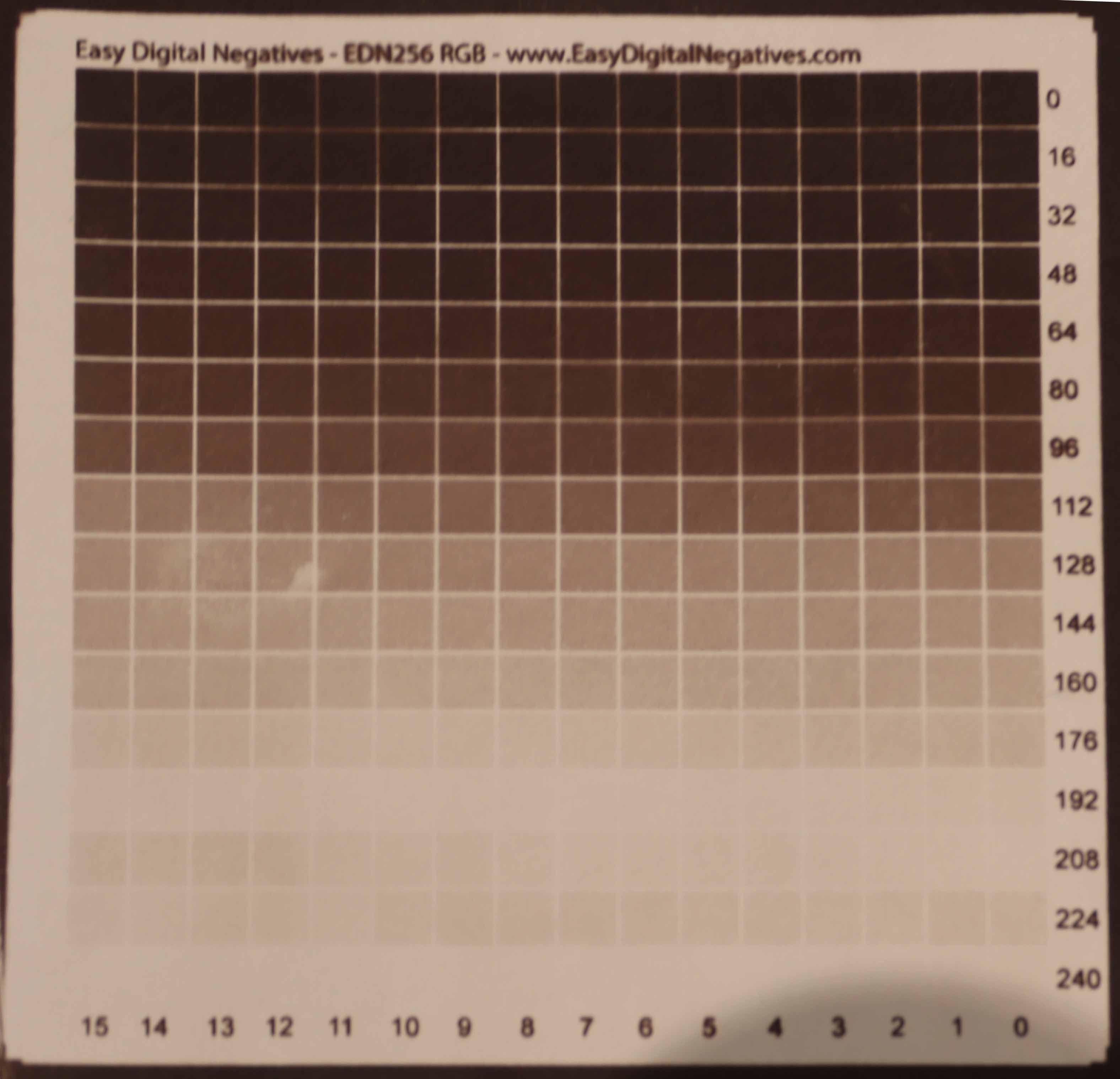

What is the problem if there is extra non-linearity in the correction curve, I am not able to understand
Well results are not repeatable enought to finetune the curve to that level of precision.
I does not remove the tints completely. Paper profiles seem to have more impact in this particular case. I can probably find a reasonably good combination of paper profile and negative color. But this is exhaustive, I basically have to do edn colorblocker runs for all the profiles, (maybe multiplied by other printing options). Maybe change the heuristic that chooses "optimal" color.
I made this thread not about this specific problem but just to get a general idea through what difficulties people have to go with digital negs. I am not ready to ask for help on this issue, need to do more expirements myself.
If you are curious I have attached examples. The curve has to not only be nonlinar, but also not monotone. This could be fixed easily if prints were perfectly reproducible, but they are not. I still haven't figured out the sources of variation.

Some more tests are needed, but it is highly likely that it's the film and not the printer. I turned off the profiles but tinting was still there. In the meantime I came across a blog post with examples of grayscale tables that also showed tinting. And the author ised Epson P600 rather than a cheap entry level printer. He also did some interestings tests to rule out spikes.
