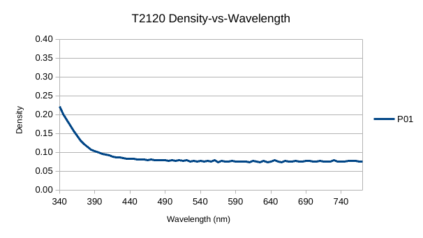

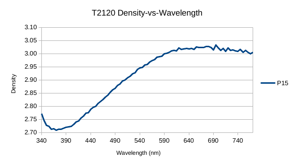

What led me down this rabbit hole was finding a metrology lab to actually do spectral scans of a T2120 strip, as a way of having enough data to basically calculate values for any density standard I like. I then discovered just how big of a difference emulsion orientation and diffuser configuration can make, and how no two standards ever seem to actually match.
Through this exercise, however, I did learn a lot about what density-vs-wavelength looks like across one of these step wedges.
At "patch 1," which is the film base, it looks like this:
But once you get to "patch 15", which has a visual density of ~3D, it starts looking like this:
(I've tried to match the scale ranges of both.)
The reason I'm bringing it up is the wavelength issue. Perhaps even more so than the VIS domain, wavelength makes a massive difference in terms of UV transmission density of materials. Combined with the proliferation of LED technology, which is fairly narrow-bandwidth by nature, this can create rather massive differences between measurements done at e.g. 365nm vs. 395nm. In a bit of a niche application (although seemingly gaining popularity), it turns out that for DAS-sensitized carbon transfer, a combination of exposures at different wavelengths is beneficial in optimizing shadow and highlight behavior in the same print. See e.g. Calvin Grier's work in this domain, and my own experiments and present printing methods are in line with this.
As far as UV wavelength, my first driving factor was attempting to get as close as possible to something else people might familiar with and/or have used before. That would be the X-Rite 361T. Now there's nothing official out there actually stating what "X-Rite UV" actually means. But I have found a few clues. First, I tried shining light into the sensor head while sweeping its wavelength with a monochromator. I found that readings peaked in the ballpark of 390nm. Second, I found some X-Rite marketing sheets which mentioned the key-word "diazo". In ISO 5-3:2009, that suggests "Type 1 Printing Density", which is around 400nm.
Of course my second driving factor was really practicality of constructing the optical path, and practicality of actually calibrating to something. The farther into the UV range you get, the wonkier the transmission spectrum of film becomes. Also, the more likely that your various light handling materials (lenses, diffusers, etc) will attenuate the UV and make it hard to get good signal.

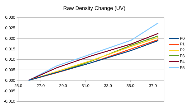

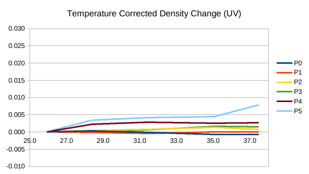

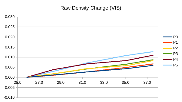

This time around, I did the same testing with slightly different conclusions. For the "Visual" channel, the temperature effect was measurable but small enough that I could get away with ignoring it. But for the "UV" channel, the effect was still relatively small, but large enough that users might actually notice. So I decided to include a temperature sensor next to the light sensor, and put together a calibration-and-correction process.
With all the corrections in place, I decided to collect some "real world" data to show its effects. I measured a T5100 step wedge at room temperature, then moved the device to an unairconditioned closet room that heats up across the day. So I effectively collected data to answer the question of "What if you zeroed the device at 25C, then took measurements at various ambient temperatures up to 38C?"
I then plotted the change in density from one temperature to the next, both before and after correction.
(On these graphs, "P0" shows the change in an open or "zero" measurement, while P1-5 are the 5 patches of the T5100.)
Of course there are a few important factors to keep in mind:
  • I've intentionally kept all these graphs at the exact same scale
  • Any error that rounds to less than 0.01D will never be noticed by an end user
  • Many densitometers only claim +/- 0.02D at the higher densities
  • For each line, I didn't average across many measurements, so don't nitpick too much into any specific line wonkiness
