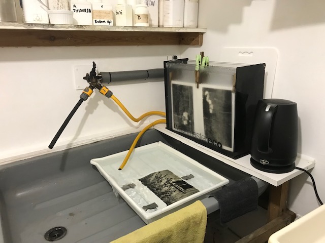

I’ve had a 16x12 Nova for a number of years, it’s permanently in place over my darkroom sink. I’ve found the hose connections do need replacing after a while with stronger aluminium jubilee screw clips. On the issue of floating prints, I use wooden cloths pegs to hold the prints in place. See picture.
