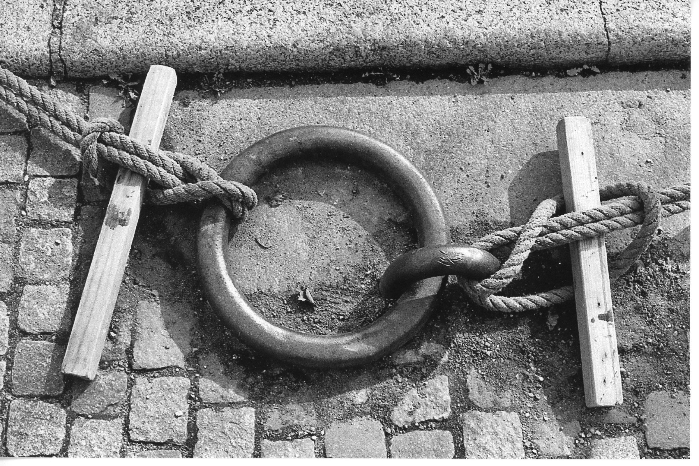

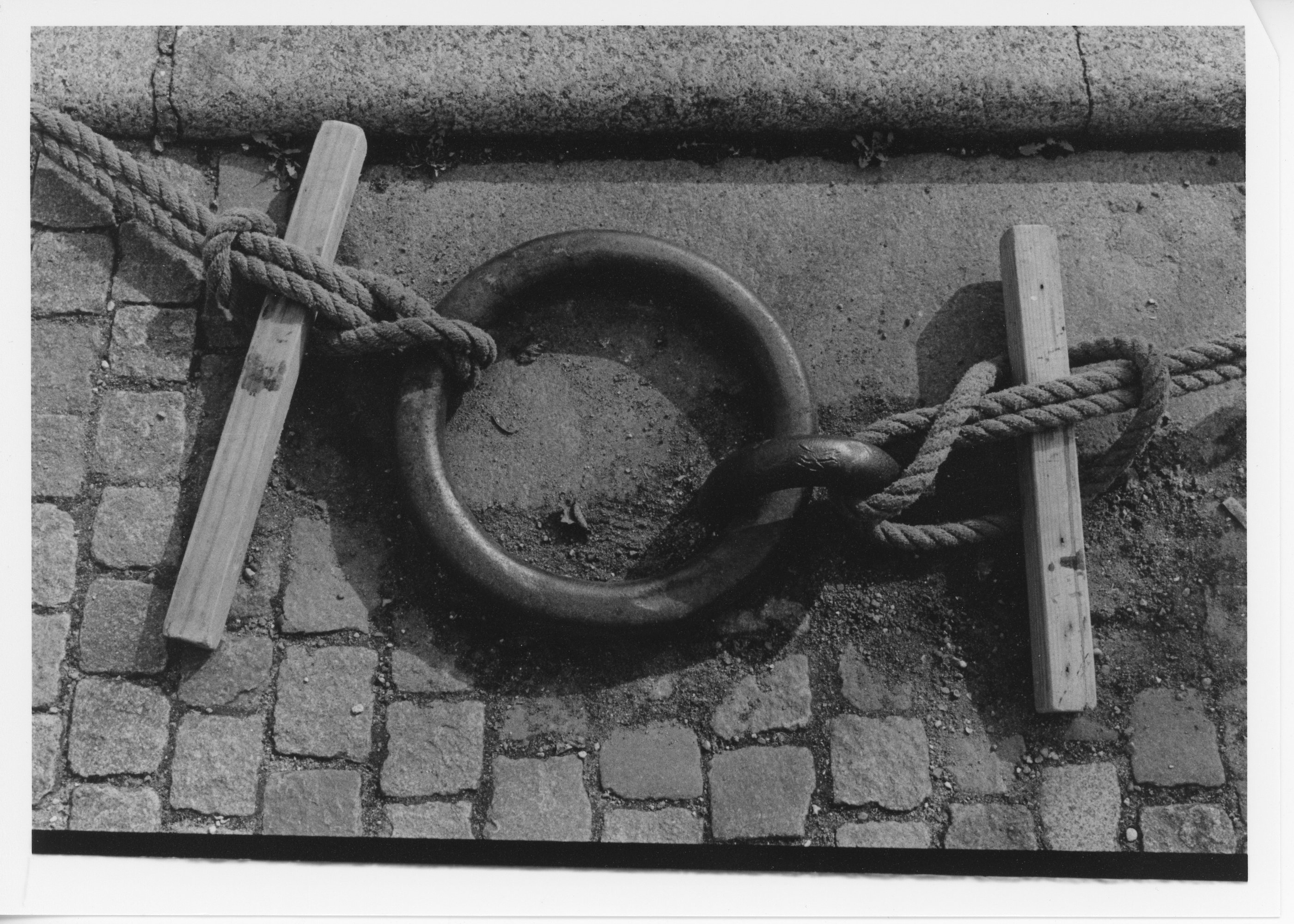

I have uploaded two scans to demonstrate the sharpness issue brought up with this post.
First scan is of a 4 x 6 digital print (scan of a digital print, 400 DPI scanner setting). This was printed at Meijer's from a scan of a 35mm Tri-X negative. Second scan is a 5 x 7 wet print (again scanned at 400 DPI) from the same negative as the first scan.
Note the difference in sharpness. You will also see a difference in brightness which you can ignore. The wet print was printed darker than the digital print (not intentional)
I am very baffled by this. Wet print looks universally softer (in focus) than the digital print. The detail in the digital print rivals that of a contact print from a large format negative.
Problem is not unique to this one photo. Can anyone offer an explanation?
The wet print is much lower in contrast, so to get closer to the look of the digital, you need to print with a filter to add some contrast. The acutance of dry prints (as you call them) is going to be higher. Add to that the fact that it's very easy to add additional acutance in post with digital, and you can get sharper looking prints. For the wet prints, make sure your image is in critical focus with the grain focuser, don't forget to put a piece of paper under the focuser. Step through the apertures on the lens and find the sharpest aperture, then look at the edges and make sure the image is in focus there. Also, better lenses create sharper prints. Is the lens focal length long enough to provide ample coverage (I like 80mm for a 35mm negative, 135mm for a 6x9, basically the diagonal of the next largest image format).
There is definitely more detail in the wet print.
The digital print has more contrast, and the appearance of the edge details has been artificially enhanced in order to create a false but pleasing appearance of sharpness.
That false but pleasing appearance of sharpness has then been enhanced by digitizing the result in the print scanning process and then again artificially enhancing the result.
"Apparent Sharpness" is a complex subject. It is made up of several components, including acutance, micro-contrast, macro-contrast and resolution. We tend to perceive those different components differently and much of apparent sharpness is subjective. Acutance (essentially "edge contrast") tends to have the highest effect on our perception of sharpness, while resolution tends to have the lowest effect on that perception. Digitization of an image is inherently destructive of acutance, but the digital tools offer excellent ways of artificially building acutance back in.
I concur with Matt.
Just for kicks, I enhanced your scan of the wet print (lightening and some "unsharp mask" sharpening); not too awfully different than what was done in your digital print. When comparing at larger than "full size" (100%), it's pretty clear that your wet print scan is carrying more detail than the digital print scan.
I base this mainly on things like the more-realistic texture of the stones, or of the gravel or dirt, etc. The digital print scan is starting to get that look of "empty magnification" while the (sharpened) wet print scan is still showing a more realistic grittiness.
