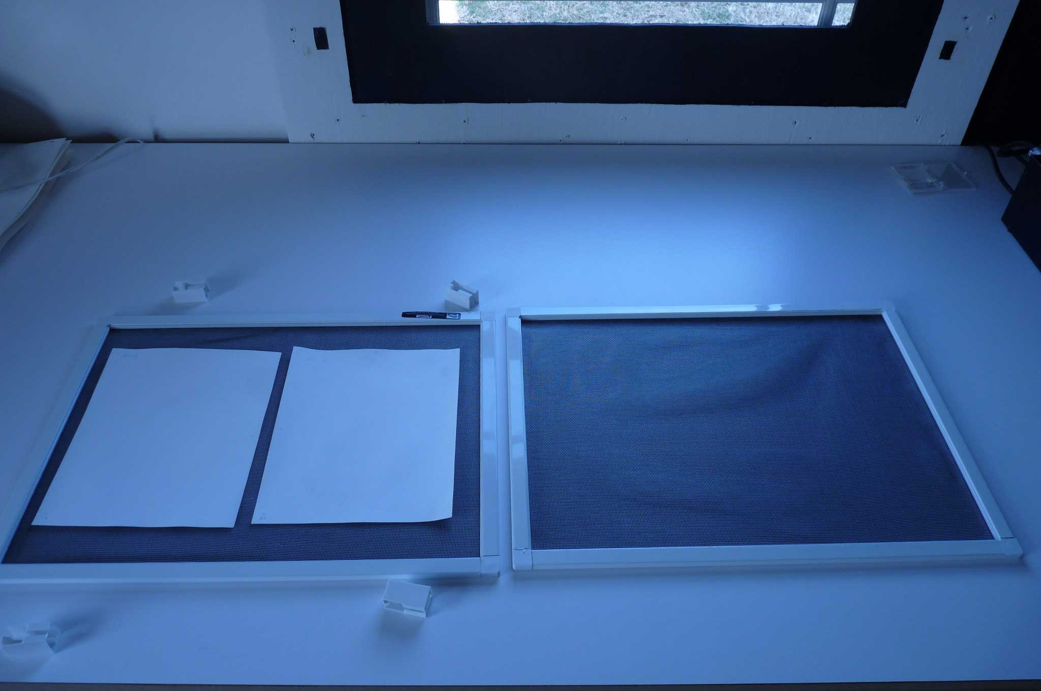

I have always used blotter paper to dry prints but I came across this screen at Lowe's that works nicely for print drying. The clips that keep the two screens together for the sliding motion easily come off so they can be separated; I sandwiched the prints between the screens but the frame allows for them to be in there loosely, drying in this manner helps keep the paper curl to a minimum, and I used the clips under the setup for better air flow below the screens. This particular one will hold two 8x10's OR one 11x14 print and it's perfect for my low production darkroom, just 3 or 4 more of these will suffice for me easily and when not in use, they'll stack away nicely-----just putting it out there for those that may be looking for something like it......cost, $5.97 each.

I keep my drying racks on a couple of rails mounted near the ceiling over my darkroom sink - out of the way and any drips (after wiping with a soft rubber blade) do no harm. My under-counter space is at too much of a premium to use it for racks. My small ones were designed for windows. The big ones (20 x 24) were custom made for another photographer.

Mine are 24x36. I made the frames of wood, and stapled the screens on. I haven't had any sagging issues. I would think the spline on the manufactured screen would stay even tighter.

Take a look at these as well. They are cheaper than H.D. and are 24x30 (still enough for 20x24 prints). Nice quality. I sized my under-counter location to handle eight of them, about 4.5" apart; they easily dry overnight without moving air through them (which I'm reluctant to do anyway as it can stur up any lurking dust when drying negatives on the over-the-sink wire at the same time).
