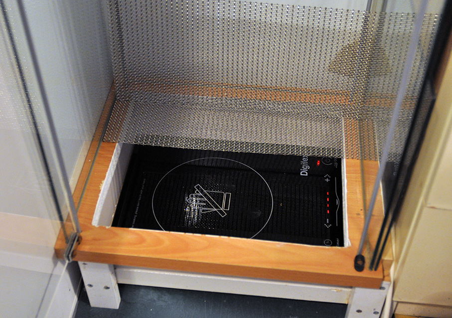

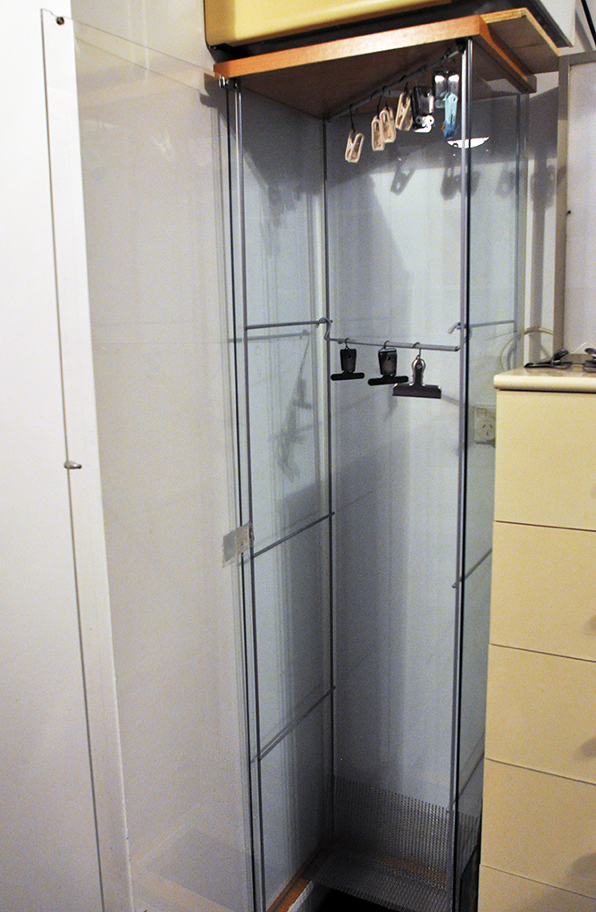

Hi, I converted an Ikea glass-sided display case as a drying cabinet. Cut a hole in the bottom and extended the height to provide hanging space for 35mm rolls of 36. Placed a small portable hotplate in the bottom. At the lowest temperature setting I set the timer to 35 minutes and all negs dry very well in this time. I have a metal grate over the hotplate in case anything falls off to reduce any risk of melting plastic! As the display case comes with multiple glass shelves I can also stack large format negs above each other and use a slip of foam on the glass shelf to catch the drips on the higher shelves. Also in the photo you can see an adjustable rail. 120 rolls go on the lower rail and 35mm on the higher. Its a nice slim profile compared to many commercial dryers and very cheap to make.

Hi, I converted an Ikea glass-sided display case as a drying cabinet...
That's close to the same size that I'm thinking of building; have you tried drying prints in it? If so, how well did that work?
