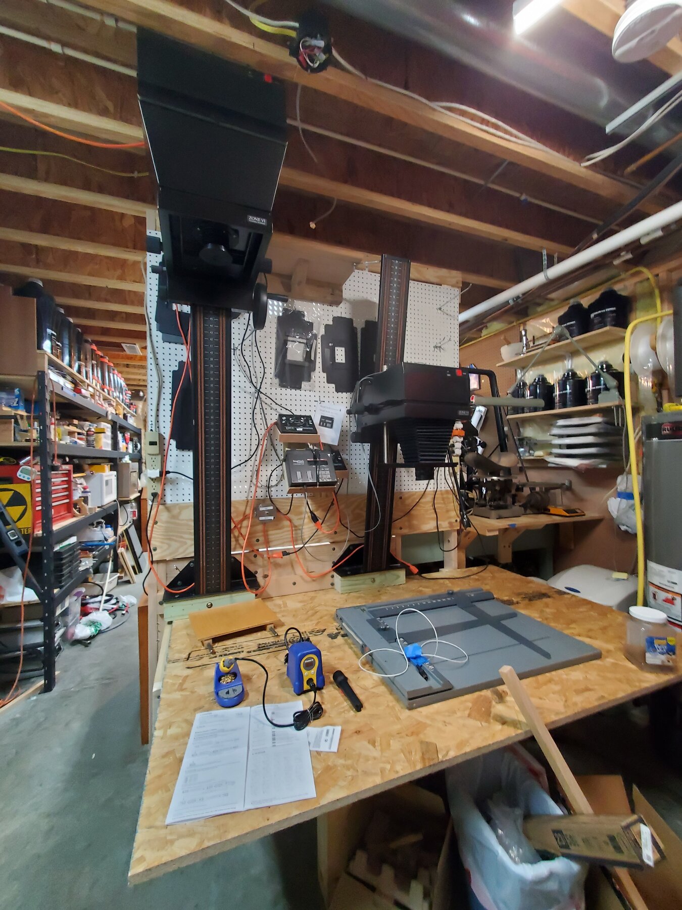

I have no idea about the European market. But everything depends on the condition and completeness of the machine. I got a fully equipped L184 color unit for free about 12 yrs ago, and spent about a thousand dollars fully refurbishing it. It cost around $22,000 US when new. I've also refurbished a couple of 138 units. Just finding a negative carrier in pristine condition might cost over a thousand dollars (or free, if you're lucky). But these commercial Durst units are wonderful built.

I did convert one of my L138 5x7 chassis into an 8x10 cold light unit, which will fit in a room with a standard 8 ft tall ceiling. My other L138 was fitted with a "hot rod" customized 5X7 additive (RGB) pulsed halogen colorhead, which is in the same room. Now of course, one might opt for some kind of low-profile LED head; but it probably wouldn't have as much lumen muscle as a traditional halogen colorhead. The biggest advantage of LED is that it would run cooler.
But L184's need a minimum of 9 ft (I have a 15 ft ceiling in that room). I made a new laminated baseboard for mine, and had Custom Bellows in the UK make me a new bellows. After I either polished or repainted all the metal, cleaned the internal filters, and rewired the unit (one month of weekends for the entire project), I ended up with a 100% functionally restored unit, with around a 95% cosmetic restoration. It was a fun enjoyable project. I already had numerous suitable lenses.
