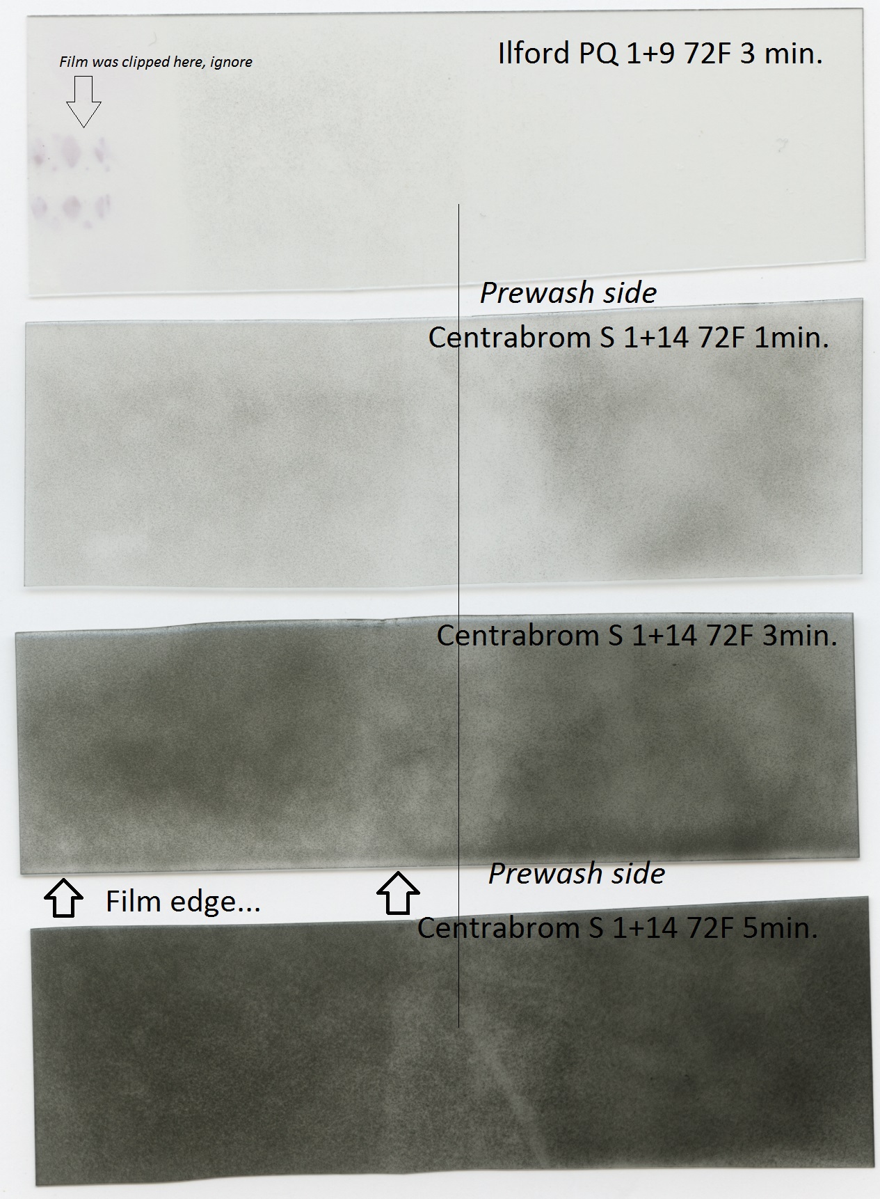

I reran my tests and have some results to share. Perhaps I was attributing too much to the prewash, but a similar test done previously showed more profound differences than what appears here. Now the concern (or curiosity) is that grain appears on unexposed then developed film using Centrabrom S.
For this test I cut a sheet of 4x5 Ortho Litho film into four strips and presoaked half of each strip in distilled water. Then I developed three strips in Centrabrom S for different times and the fourth strip in Ilford PQ. The strip developed in PQ was clear; the strips developed in Centrabrom showed pronounced grain with increased time in the developer. All of this was done in complete darkness. Film and developer are new. The prewashed side is on the right.

I should mention that I looked at the negative under a loupe, and the grain does appear in the deepest shadows and unexposed edges, consistent with what's shown above. But it doesn't seem to show up in my contact print. Enlarging might be a different story.

bvy, I have the strong impression that you are not fighting with grain, but with fog. If you have density in an unexposed area, you should fight the density, not reduce its granularity. As you know, film contains all kinds of compounds that keep the emulsion stable, and one or more of them may provide additional restraining action, which you wash out in your prewash.
My recommendation is you either use a different developer, or add some Potassium Bromide or Benzotriazole to your Centabrom S.
