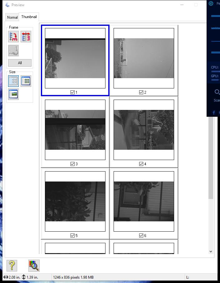

When previewing negatives, sometimes 35mm but primarily 120, the Epson does not scan the whole image but chops it into parts. The 120 film holder contains 2 x 6x6 negatives, the software setting is 6x6, but I'll get one or both images comprised of the gap between frames, with part of the other negative in the square and part of the one I want to scan missing. I place the negatives or slides carefully in the holder.
I don't believe I can set a marquee line before a preview scan, only for an actual scan after the preview. Does anyone have a solution?

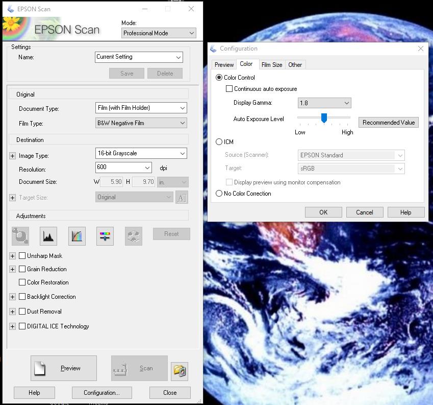

My basic configuration for evaluation of the negative ( I sometimes select NO Color Correction)

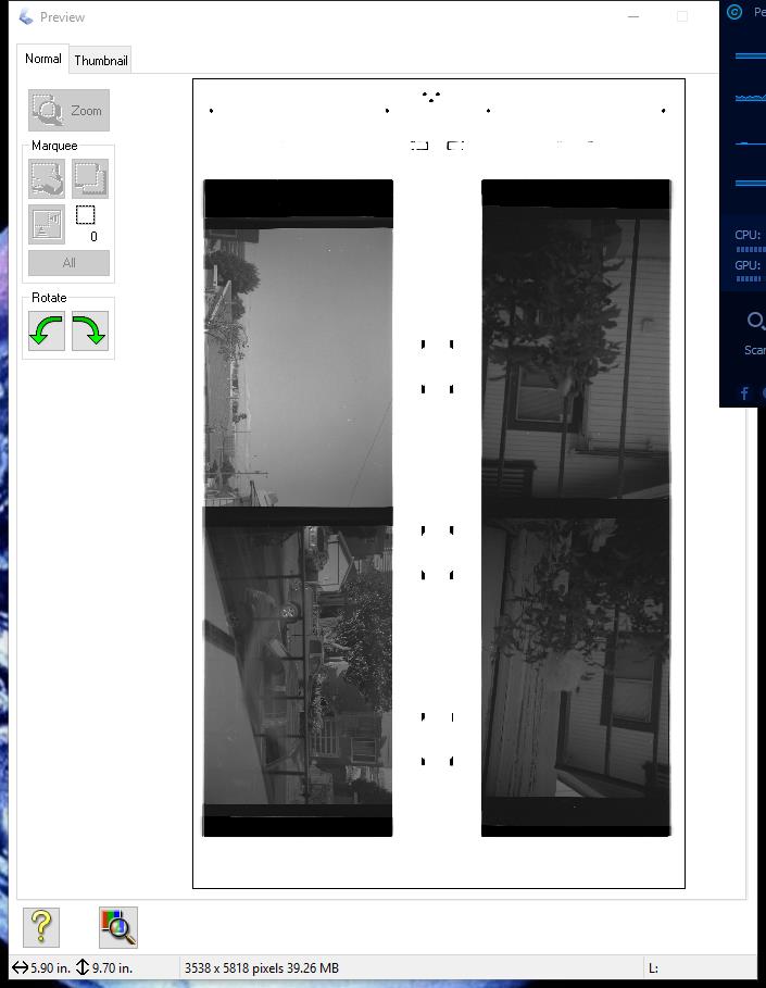

Selecting the Normal tab I get

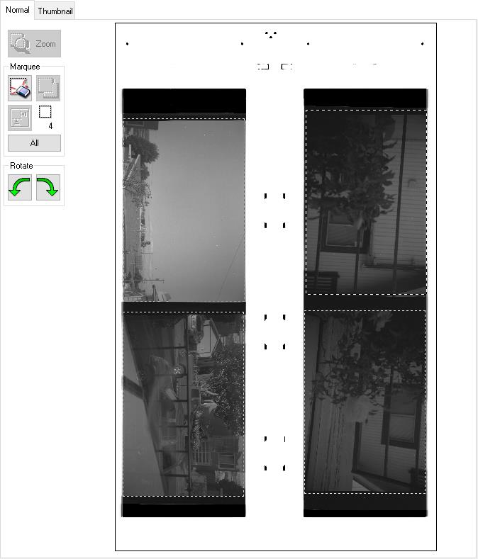

epsonscan 3.jpeg Pressing the Marquee box I get a "marching ants" box that can be positioned and adjusted. The mouse cursor becomes a Hand when inside the marquee box, clicking and holding the box can be positioned as desired, releasing the click and positioning the cursor over the edge of the box until the cursor turns to a double headed arrow then clicking and holding that edge can be adjusted as desired.

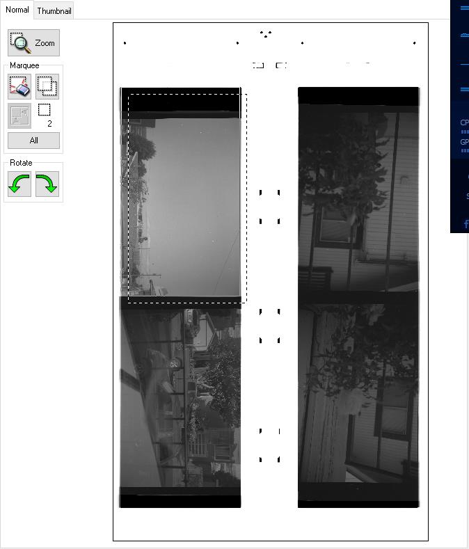

Now pressing the double marquee box a second marquee is displayed offset to the first that can be moved to the next frame. The next marquee will be the same dimensions as the previous adjusted marquee.
Finally when all frames are selected with a marquee box select the ALL box then press scan.
All marqueed frames will be scanned in the order their marquee boxes were applied.
