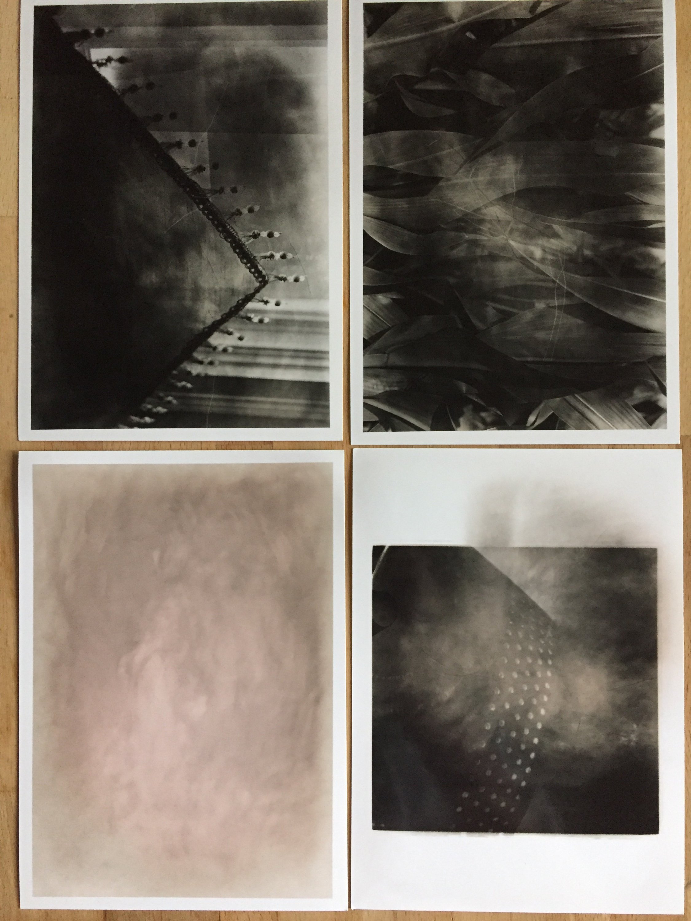

I've been setting up a new darkroom after a few years off. I've got almost 200 sheets of Adorama-branded 5x7 RC glossy multigrade paper that's about 4 years old, purchased shortly before I shut down my old darkroom. There are no dates on the box. My chemistry is fresh.

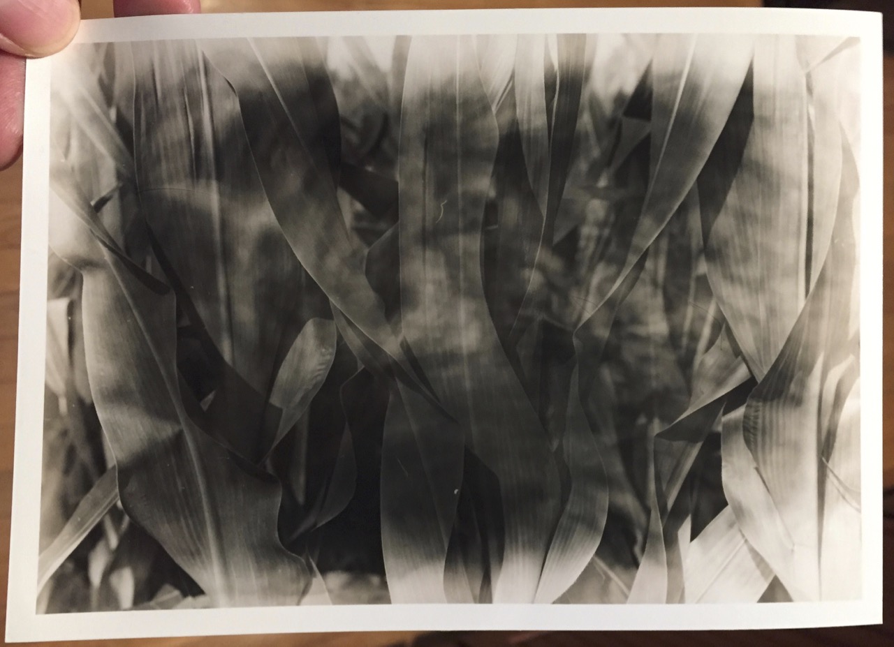

I've tried a few test prints on it, and they all exhibit serious splotches and uneven development, and a brown tone, as in the attached photos. These show up on two different enlargers, with or without negative in the holder, and even if I work in total darkness, no safelight. They don't show up if I take the paper straight from the box to the developer tray - there has to be some exposure. I used some 20+ years old Kodak paper as a "control" - that paper, though it's d-max is like, dove grey now, shows none of this splotching.
This Adorama paper is shot, yes? I'm thinking it's not good for anything, not even paper negs or photograms with the kids.

I don't have enough experience in the darkroom to state anything with real confidence, but two points make me suspicious of the processing rather than the paper itself:
The swirl patterns look similar to the effect you would get in water with a few drops of dye barely mixed in, which would make me wonder about how well the developer was mixed [or contaminated/exhausted]

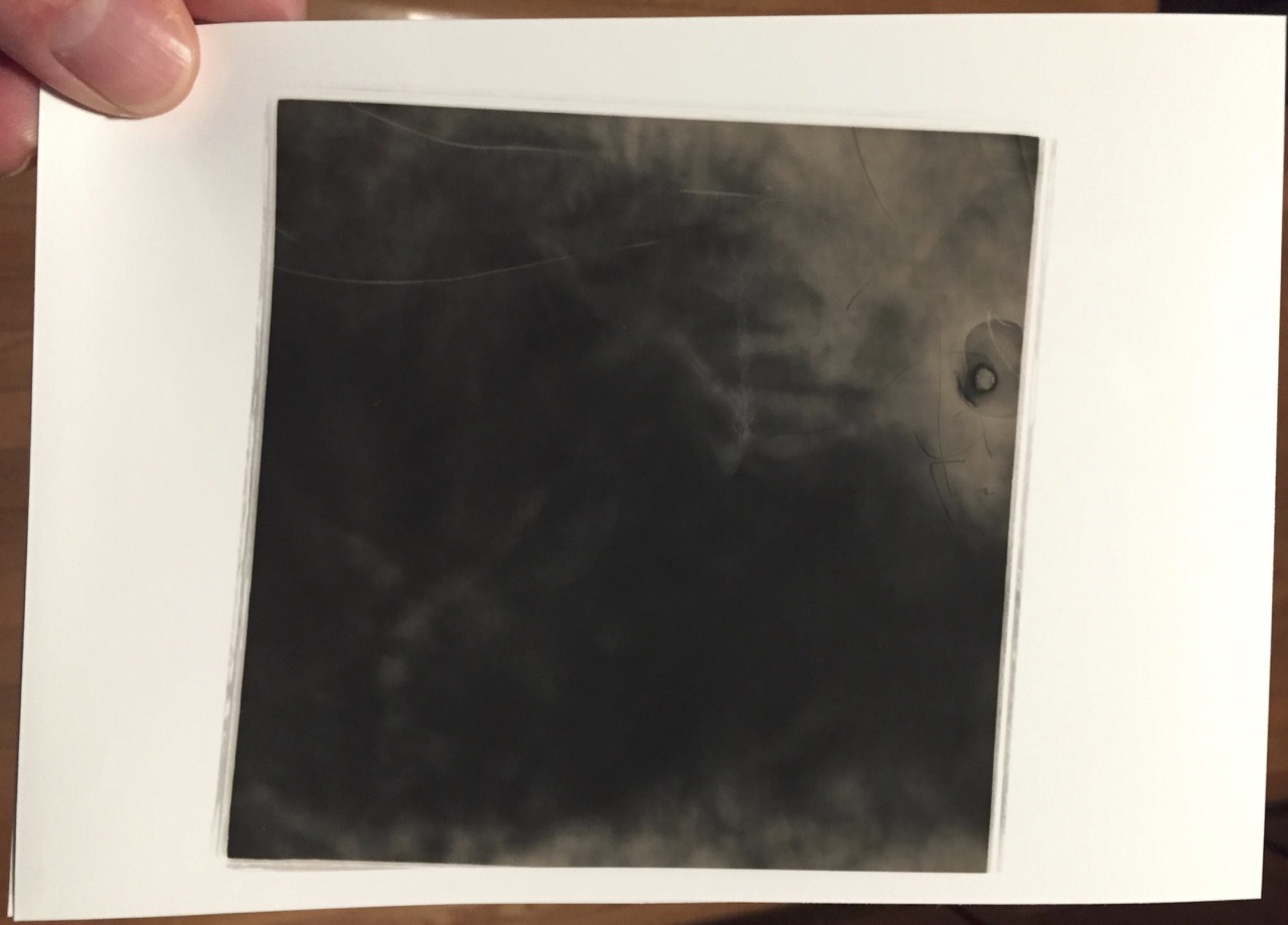

Your third photo also shows areas of poor processing at both the edges and the centre - I'm assuming this isn't individually coated sheets of paper, so I would expect any production issues to not align to individual sheets [The patterns would run across the whole paper and not consistently impact all the edges/the centre of any individual sheet after it is cut from a larger roll], and I would also expect any post production issue of the paper to either work from the edges in, or be relatively evenly patterned across the whole surface.
I can't think of any contamination or chemical failure process in a paper's coating that would impact both the centre and edges that consistently.
To me this looks like a wave pattern in a tray that is keeping the most active chemical reactions in a ring about 1/3rd the way from the edge of the paper, and not enough fresh/active chemistry at the edges/centre.

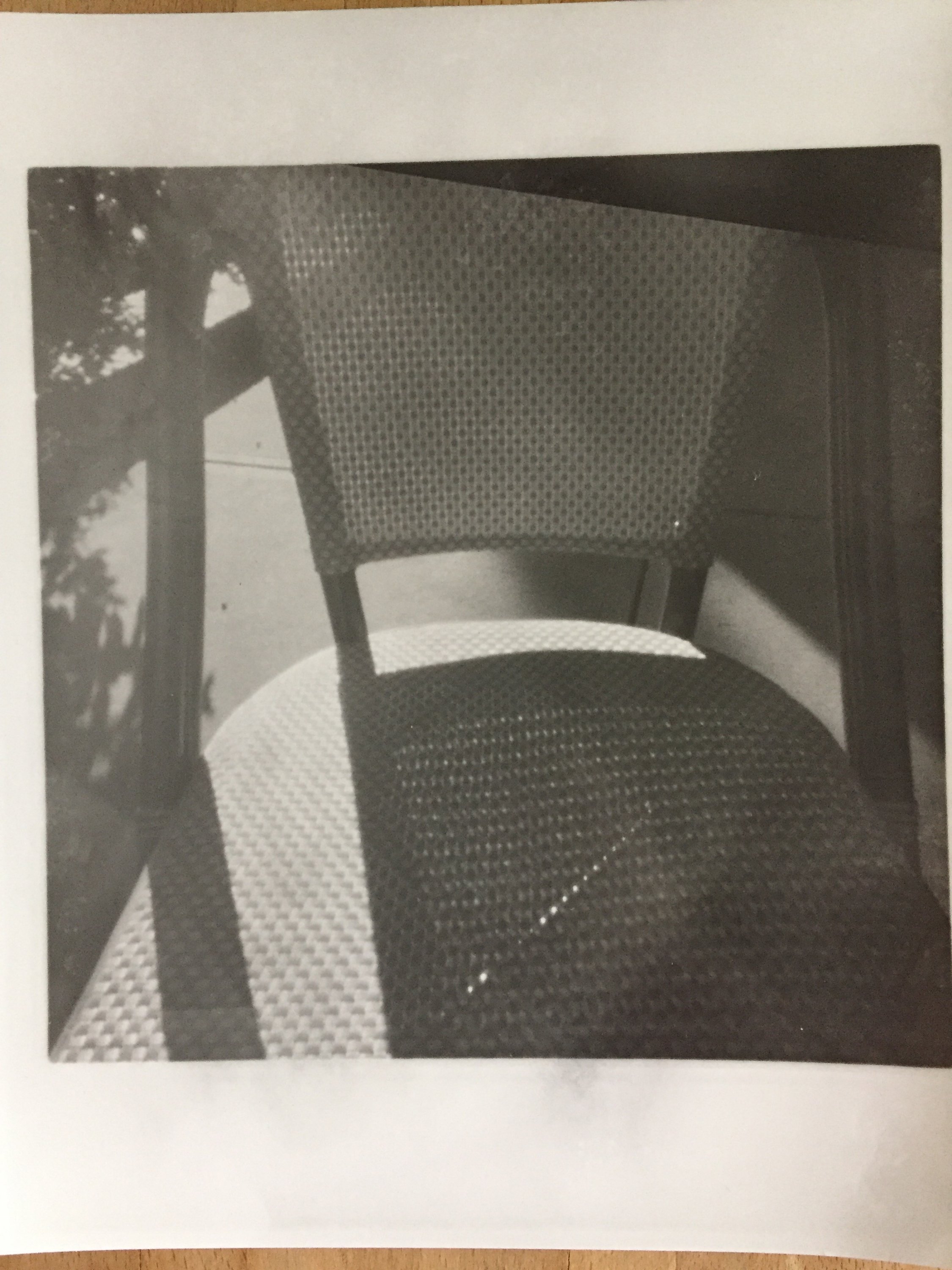

Yep - the control was the exact same conditions, including developer, just a couple minutes apart. The developer was fresh and mixed from liquid concentrate (Sprint Systems), all the gradients, mixing containers, trays etc. involved were clean, and dedicated to developer chemistry only. The tray was filled nice and deep, 8x10 tray for 5x7 paper as I always go up a size for ease of handling, I do a kind of randomized agitation to prevent any wave pattern...
I know these patterns are really weird, and unlike anything I've seen in even deeply expired paper, but I'm not a total noob, and I did enough of these to eliminate any really obvious errors...

I find it interesting that the borders show no signs of fogging.
{snip} I find it interesting that the borders show no signs of fogging.
Right? It's only where the light hits. And it's not the safelight, the middle photo was done in total darkness for that reason.

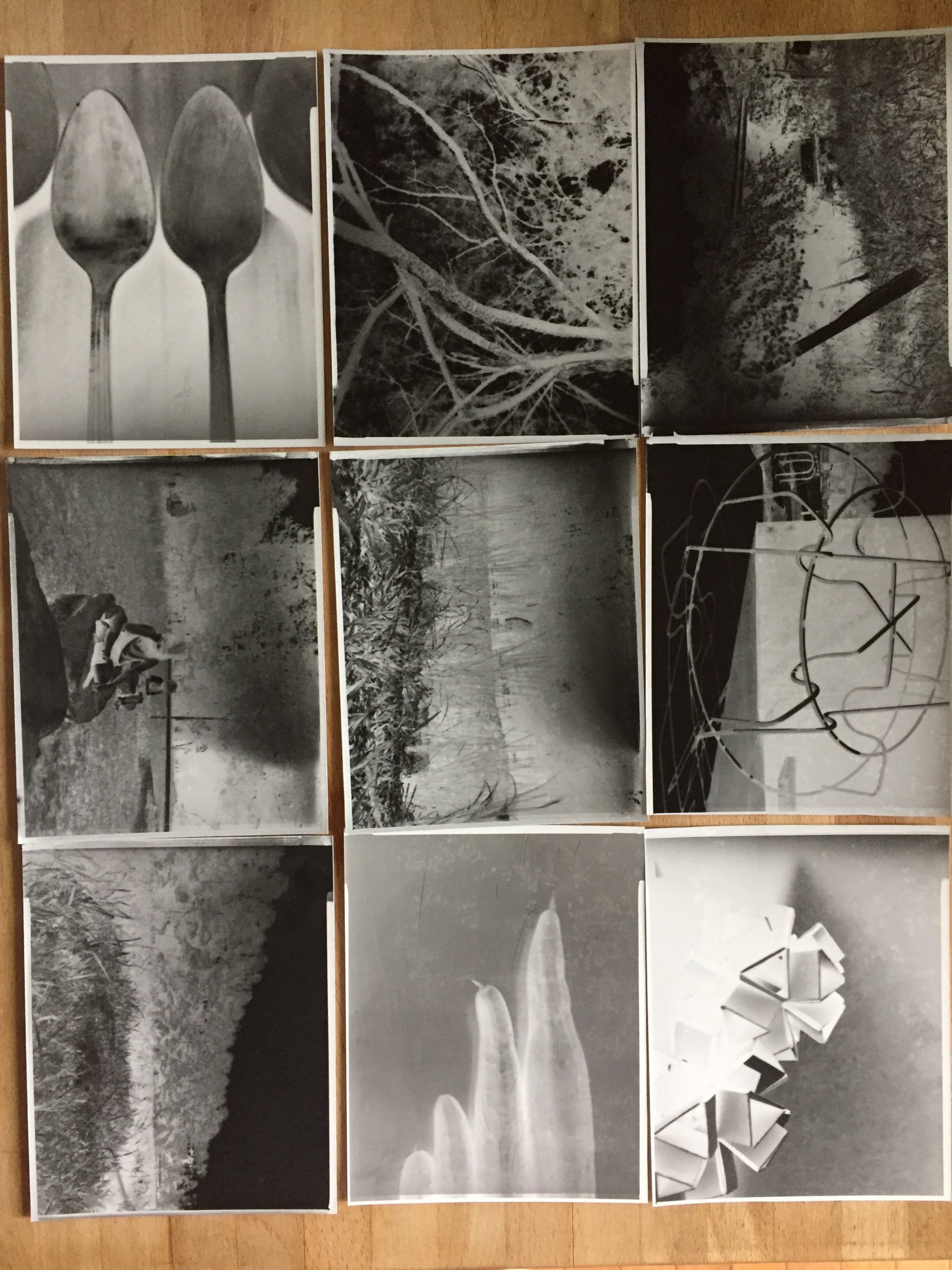

For the heck of it, here are some images of additional development with this same batch of working solution that I've now poured in and out of trays at least 6 times:
4x5 pinhole camera paper negatives cut out of the same ancient Kodak paper I referenced above as a "control" - some were exposed and developed 7/25/20, the rest exposed over the following few days and developed 7/29/20, no hint of swirl:
Top two: The very first and second pieces of the probably-bad 5x7 paper, exposed and developed less than an hour after the working solution was first mixed. I've scanned both those negs and those huge dark areas are not on them; bottom two: exposures with and without negs in a different enlarger, about a week later:
A full 8x10 sheet of the old "Kodak" control paper, ACROS in a 6x6 pinhole camera, a crap exposure and showing the paper's age but no swirly funk:
