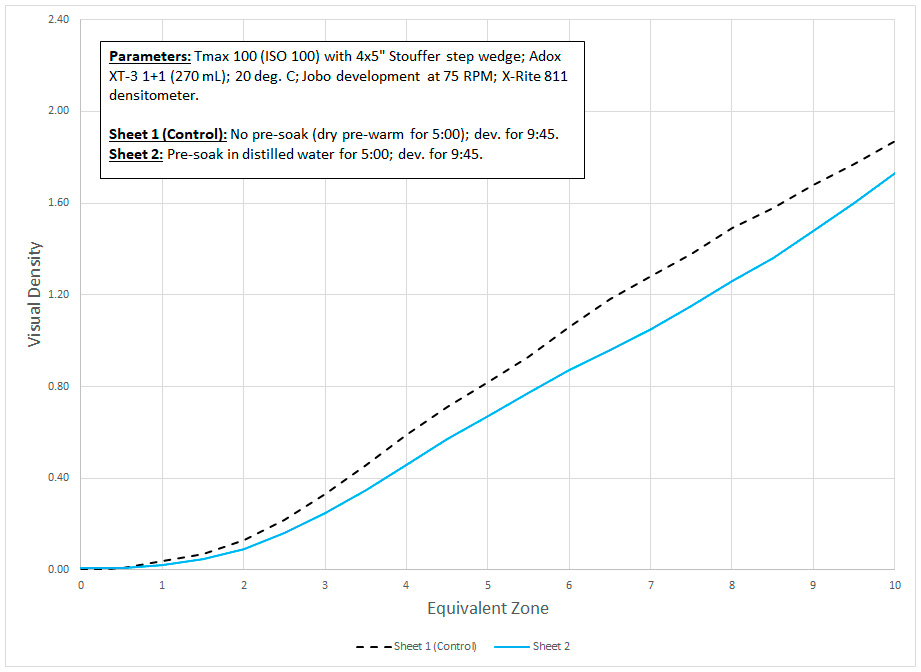

Once a sheet of film was dry, I used an X-Rite 811 densitometer in Status M mode to measure the visual density of the various steps recorded on the sheet. I checked the calibration of the X-Rite with a calibration target before each set of measurements to ensure it was reading accurately. In total, 22 density measurements were made for each sheet of film – one measurement to determine the base plus fog (B+F) density, followed by an additional 21 measurements to cover each step in the wedge. The density measurements plotted in the charts below are all “net” density measurements, where net density equals the density measurement of each step minus the B+F density.
Sheet 1 is my control sheet and was developed for 9:45 with no pre-soak. To ensure temperature consistency, I used a five-minute, dry, pre-warm step with the tank rotating in the Jobo to develop Sheet 1. Sheet 2 was similarly developed for 9:45, but utilized a five-minute pre-soak in distilled water while rotating in the Jobo. All other development steps were kept the same. The density curves for Sheets 1 and 2 are plotted in Figure 2 below.
Figure 2: No pre-soak vs. pre-soak density.
The above result really surprised me. Although I expected some loss of density in the sheet developed with a pre-soak, I didn’t expect it to be this significant. These results do strongly suggest that, at least for this specific film-developer-processor combination, doing a water pre-soak does inhibit development to some degree.

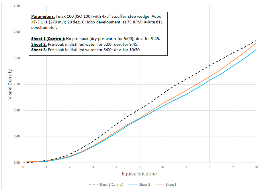

My next step was to develop a third sheet of similarly exposed film using a five-minute pre-soak plus extended development time in an attempt to compensate for the loss in density seen in Figure 2. Sheet 3 was developed for 10:30, which is equivalent to an additional 7.7% of development time over the standard time of 9:45. The density measurements for Sheet 3 are plotted along with those from Sheets 1 and 2 in Figure 3 below.
Figure 3: Evaluating the effect of extended development time (+7.7%) following a water pre-soak.
As can be seen in Figure 3, 7.7% wasn’t enough additional development time to compensate for the loss of density due to the pre-soak. I had initially guessed that 5-10% additional development might be enough, so this result was another surprise to me. There’s also a curious observation to be made in the shape of the curve for Sheet 3. Specifically, there's a steeping of the density curve in the highlights near Zones 9 and 10. My instinct is that by extending the development time to compensate for the loss in density due to the pre-soak, we end up with over-development in the highlights. This seems consistent with what photographers generally assume will be the effect of increased development (i.e., greater impact on highlight density and a corresponding increase in overall contrast).

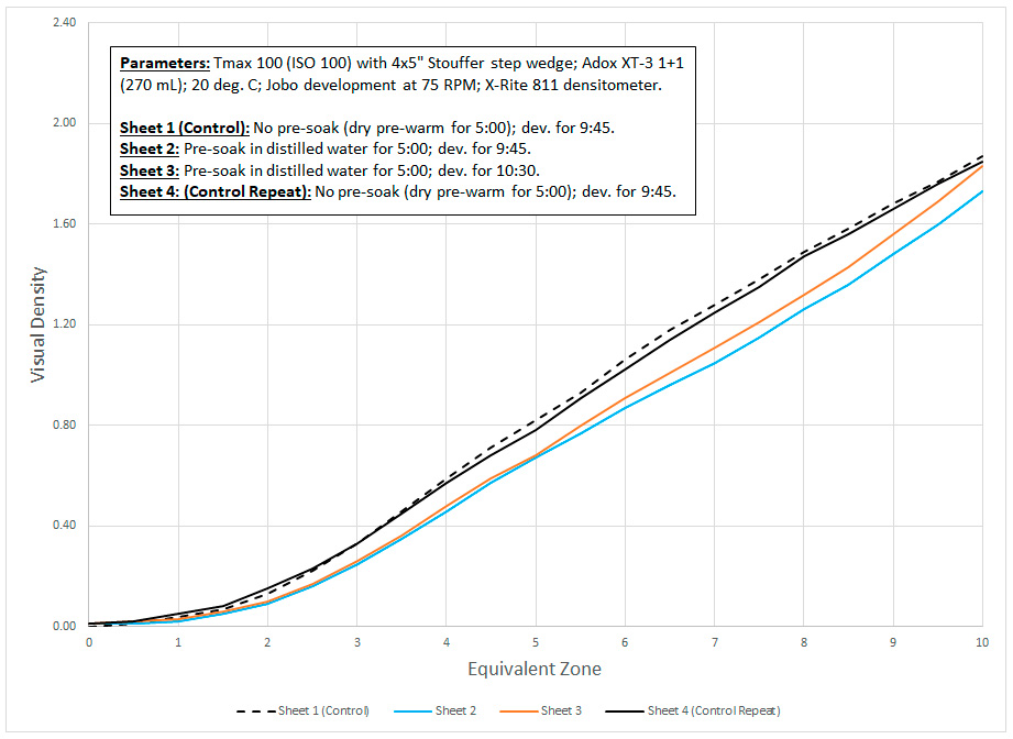

Because these were surprising results, I wondered whether my control sheet (Sheet 1) might not be a fluke (e.g., metering error, etc.). To investigate that possibility, I exposed three more sheets under similar conditions the following day. Sheet 4 was developed as per normal (9:45, no pre-soak) to provide a check on the accuracy of my original control sheet. The density measurements for Sheet 4 are plotted with Sheets 1-3 in Figure 4.
Figure 4: Repeatability test on the original control sheet. The density curve for the repeat control test (Sheet 4) closely matches that of the original control test (Sheet 1).
As can be seen above, there’s very little difference in the density curves of the two control sheets. What difference there is can likely be attributed to the +/- one-sixth of a stop uncertainty in the metering and exposure settings. On the whole, I feel Sheet 4 confirmed that my control densities measured in Sheet 1 were accurate and representative of the standard development. Consequently, I’ve chosen to continue using the Sheet 1 density curve for all subsequent comparisons.

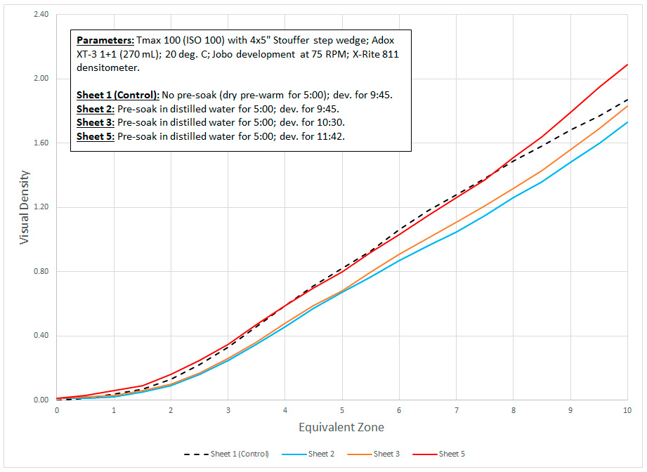

Next, I made a second attempt at determining how much additional development is needed to compensate for the loss of density due to the pre-soak. Sheet 5 was developed for 11:42, which is equivalent to an additional 20% of development time over the standard time of 9:45. The density measurements for Sheet 5 are plotted with Sheets 1, 2, and 3 in Figure 5.
Figure 5: Evaluating the effect of extended development time (+20%) following a water pre-soak.
This result compared well with the densities in the original control sheet, particularly in Zones 3-8, which suggests that 20% of additional development time may be a good place to start with this film and developer combination. That said, Sheet 5 exhibits the same rapid increase in highlight density that was previously observed in Sheet 3. This is, again, consistent with the idea that extending the development time has a disproportionately large effect on highlight density. This might make extending the development time problematic -- i.e., you can counteract the effect of the pre-soak on the shadows and midtones by simply extending the development time, but doing so may come at the expense of blown out highlights. That said, it’s debatable to what degree we need to be concerned with density in Zones 9 and 10, since we’re usually trying to engineer an exposure in such a way as to avoid recording overly harsh light.

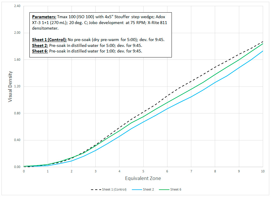

For my final test, I wondered if the duration of the pre-soak might be having an effect on the development. In developing Sheet 6, I reduced the pre-soak time from 5:00 to 1:00 and developed using the standard time of 9:45. The results are plotted with Sheets 1 and 2 in Figure 6.
Figure 6: Testing the effect of pre-soak duration on density. The shorter pre-soak (Sheet 6) exhibits less inhibition of development compared to the sheet pre-soaked for 5:00 (Sheet 2).
This was another interesting result. It appears that the duration of the pre-soak does correlate with the degree to which the development is inhibited. Going off my previous hypothesis about how pre-soak water in the emulsion dilutes the incoming developer, it makes sense that a longer pre-soak would result in more water uptake in the emulsion and, hence, greater dilution of the incoming developer. I suspect there are lower and upper bounds to this effect, meaning: The inhibition phenomenon probably begins building at the very moment the pre-soak is initiated, and then reaches a maximum level after a few minutes. Presumably, this would be slightly different for every film type, developer, dilution, and agitation scheme.
