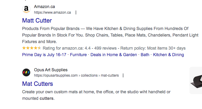

they must be distant cousins

Bob,
If you click on any of those "two t" search results, more likely than not you will find the content behind them using "Mat" :smile:.
I know, I know - I'm just being too sensitive about these things 😇 .
