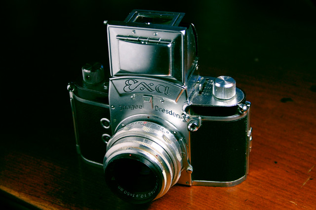

On the subject of chrome, I don't think anybody did chrome as well as Exakta did. I love the softer/smoother finish Exaktas have compared to other cameras.
