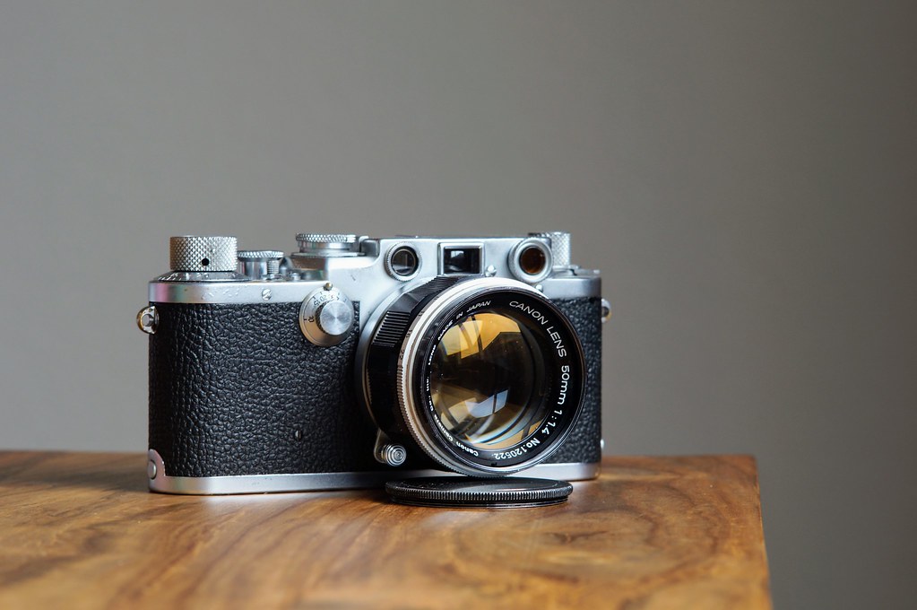

In terms of balance and ergonomics, the Canon 50/1.4 LTM is probably not well suited for a smaller body like Patrick noted. It's a wonderful lens, but mounted on a Barnack it is very front heavy and partially obscures the viewfinder.
The Nikkor-H.C 5cm f/2 recommended a few times above is a much better balance. While heavier and less compact compared to a collapsible Elmar, the aperture is less fiddly and its smaller size does not obstruct the viewfinder (40.5mm filter thread compared to the Canon's 48mm). If aesthetics matters to you, the chrome finish is a good match for a Barnack.
