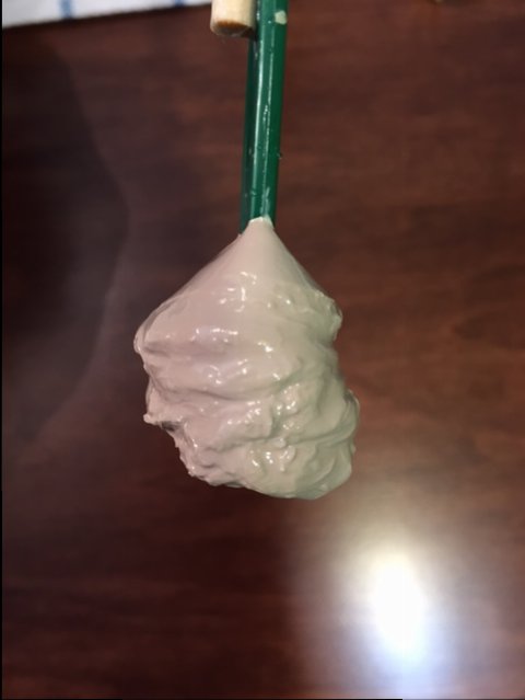

I've also found out that by playing with pH too much at coating time it is very easy to create a ball of glop.
I've done this twice. Twice is enough!

The emulsion should NOT coagulate like that unless you are using PA gelatin.
