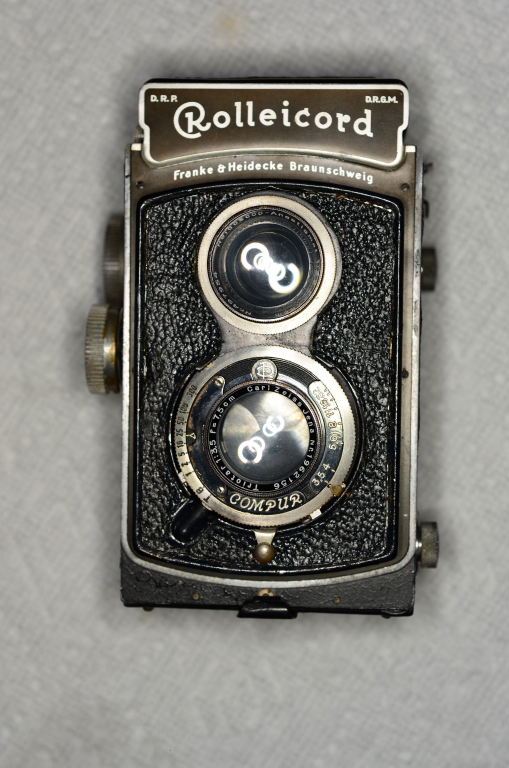

Family car ride got us by a thrift shop, and there, in the glass case, was a TLR
Rolleicord, a bit frozen.
Shutter looked inoperative, so I passed, even for the $14 rice tag.. born frugal I guess.
Back home, I was able to, I think, identify it as a likely K3, made around 1938, using the RolleiClub site's visual records. There was film in there, pink backing paper, so kind of old..!
What is the likelihood of getting the shutter working?
Film transport, focusing were frozen, and I had to apply pressure. I did a bit of the same with the single shutter lever, as there was no real feeling of cocking in, or release.

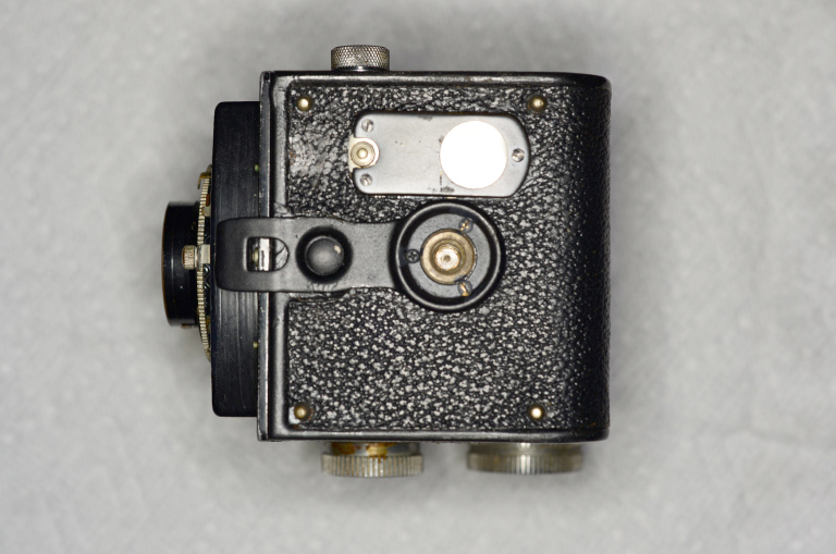

Well, it is home now!

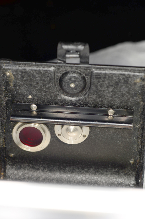

Two main issues that I can see:
inoperative shutter, was known going in
broken film door metal spring-y catch, with part of it still screwed there
Also
slight corrosion on aluminum film pressure plate
Ancient exposed roll of Verichrome - not sure about develop it myself, special treatment?
Oddly, both spool ends read "Kodak Brownie".
Also odd: camera came with a 2 x 2 3/4 Polaroid B&W print of a 1950s smashed car, driver side! Mystery.

You can just tape it shut.
Mine has slight corrosion on the pressure plate as well.

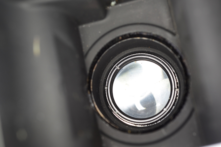

Update: with front taking lens element out, a gentle naphta application on blades, and AFTER I found the B setting, I can clearly operate the B setting at will (EDIT without cocking first), with a good feel on the release throw.
Had I found the B setting earlier -was gummed up, I would have skipped the naphta. Oh well.
Shutter blades look clean, BTW.

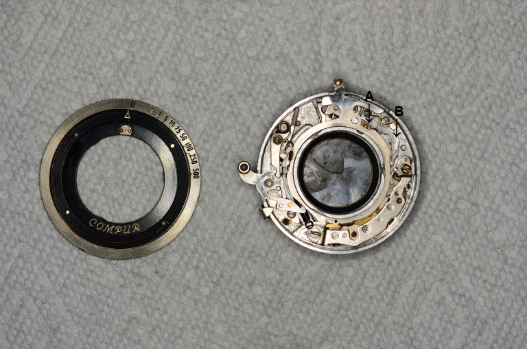

DSC_0550_00002.jpg DSC_0549_00001.jpg DSC_0554_00004.jpg DSC_0553_00001.jpg inner ring-element retainer; knurled ring- shutter retainer; rear lens hood and velvet or felt light trap.
Compur Rapid shutter nearly identical internally as a Compur 1/300 shutter.
Piece A should move freely on the cocking lever and has a hair fine spring. It should slide freely in slot B which is partially obscured by the cocking lever.
Shutter will not cock if A does not move freely in the slot.
