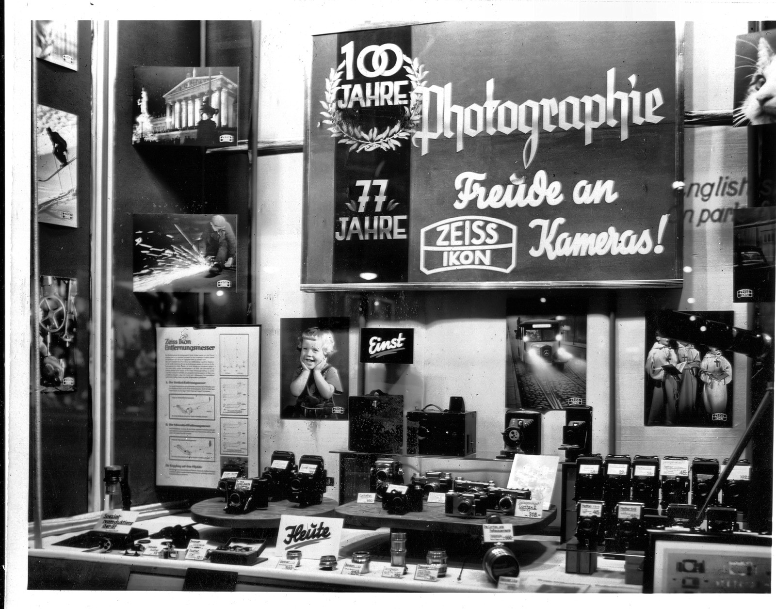

This isn't in the U.S., but gives a good idea of what was displayed in shop windows in pre-WWII Germany.
I am not sure whether this shop window is representative.
It is dedicated to Zeiss-Ikon cameras but lacks their box cameras. Being obviously a "sophisticated" camera store with a non-average clientele. The box cameras likely would be found in the shop window of a photo-drugstore, a type of retailer that made the majority of photo retailers.

I see 2 box cameras, a TLR, a handful of what appear to be 35mm, and a metric ton of folders. Seems to be representative of the Zeiss range for the late 30's (there's a Contax III, I believe, which apparently came out late 1936), although I'm nowhere near an expert on the Zeiss lineup.

The two big ones are no classic box cameras.
