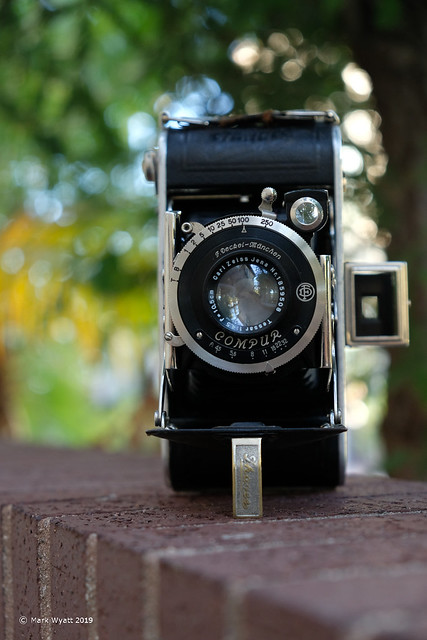

I picked up this Ihagee Ultrix 3860 (6x9 or 1/6 glass plates) on ebay for around $80 with a nice Zeiss 105mm f4.5 Tessar (I date it around 1938+/-1 year). First introduced in 1931. This camera worked as-is (I had to tweak the film holder spring a little- got some suggestions on Photrio to trace an issue with loading the film).
Ihagee Folder
by Mark Wyatt, on Flickr
It is not much different than earlier Ultrixes and other Ihagee, Zeiss, etc. folders from the 20s/30s, and by the time they stopped production in 1939, I suspect the Exakta was taking all their attention, and this was already looking like a dinosaur (folders continued, but glass plate cameras started decreasing). It takes really nice pictures (I suspect modern film helps too). Many serious photographers in the 1930s had a great suspicion about that dang roll film, and even worse, kine film! Glass plates stayed flat and produced the best images...
