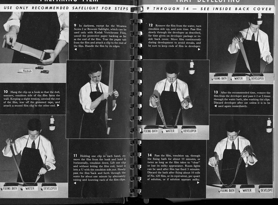

I'm surprised that at the new darkroom I go to they do not pre-wet film before the "first" step which is developer (D-76)
I only learned about a pre-wet at Apug.
Look at #11 in the attached "demo".
Kodak has recommended this from day 1 when processing film. I learned to use a prewet and still do.
PE
interesting they dont' suggest using stop bath in that demonstration ...
they just say water, developer, the same water and fixer
Look at #11 in the attached "demo". Kodak has recommended this from day 1 when processing film. I learned to use a prewet and still do.PE
At college I learned that see-saw method, though we only used it to run the processed & washed film through a container of photo-flo before hanging in the drying cabinet. I still do it with my 120 film.
That only applies if you develop film while wearing a dress shirt and a tie :whistling:.
