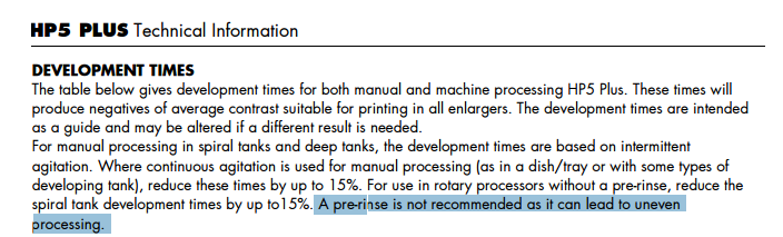

in fact ilford datasheets are clear.
Still, Ilford technicians have stated here that ilford film don't require pre-wash, but no problem if you pre-wash a long enough time, because a too short pre-wash may lead to a disaster.

Surfactant are built in in some films, Ilford uses them. If Ilford uses them I'm confident they use for a reason.
I am assuming that manufacturers do not use what is not needed, it would be an avoidable cost.
It's also written black on white in the HP5+ tecnhical sheet, as reported above.

I follow Ilford suggestion to not use a pre-wash.
Never had a problem whatsoever this way.-

Kodak datasheet only says this for TMX:
It is the single mention to pre-wash in the kodak datasheet, but it has to be noted that it speaks of the shuffle method, this is placing several sheets stacked in the tray as sheets are mentioned interleaved, so to prevent stacked sheets get glued one to the other. IMO this is not applied to developing one sheet at a time in the tray.
