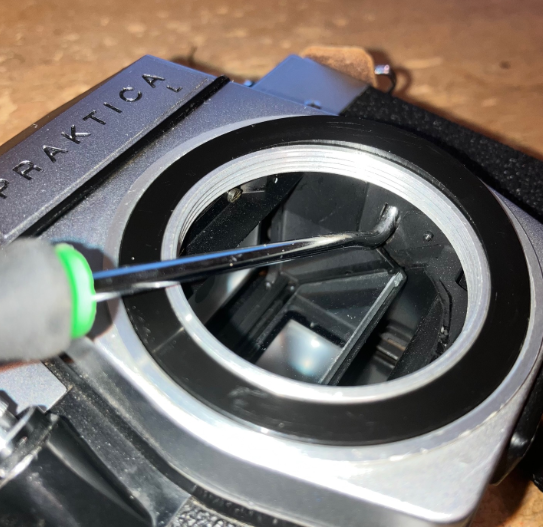

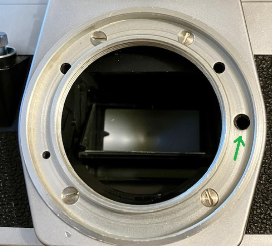

Earlier this afternoon, as I was reviewing my old reference pictures, I accidentally found the proper way to remove the lens mount plastic ring.
Inside the mirror box, there's a slot which gives access to a hole that goes through the mount. Using a small curved pick and a reasonable level of forces, the ring can easily be pushed out.
