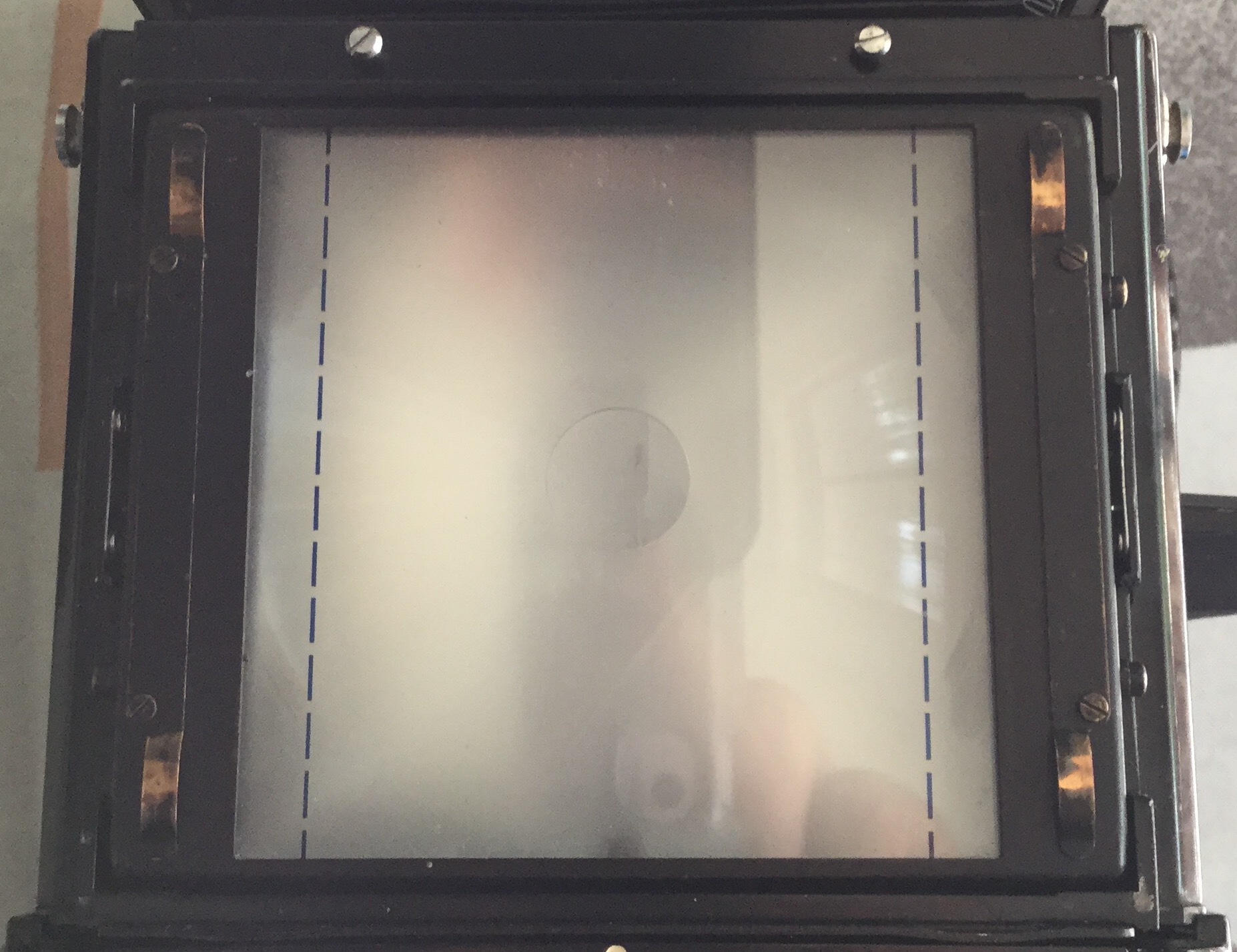

This is the focusing screen of my RB. The lines for taking pics in portrait orientation are pretty obvious. Is there a way to mark somehow or know in anyway what are the borders for landscape orientation ? changing screen would be quite expensive right now, at least from what I found on eBay.
rpavich
Aug 24, 2015
1,520
West virginia, USA
Thats' weird, mine have the marks two directions; one set for dashed and one solid set.
