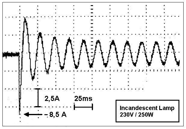

Here is a schematic for an incandescant lamp:
However the typical circuit braker is slow and would not react on such peak. The typical issue I got in my installation is with the inrush current of some power grinder.

Electrical wiring and circuit breakers should easily handle the starting surge of incandescent lamps, motors, and other appliances. Some of these surges are far greater than the one in AgX's graph above.

Inrush current of an incandescent lamp is there but very short. I wouldn't worry about it at all. When the filament is at room temperature its resistance is quite small. When you apply the voltage to the lamp the inrush current is quite high but the filament gets hot very fast and the resistance raises and the current drops to normal. I think the inrush is about 2/10 of a second.
