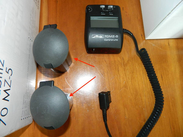

This is a picture of the Ni-MH battery packs that fit into the base of the flash.
Metz used to make replacement rechargeable battery packs, but they've since been discontinued (and they weren't exactly cheap).
