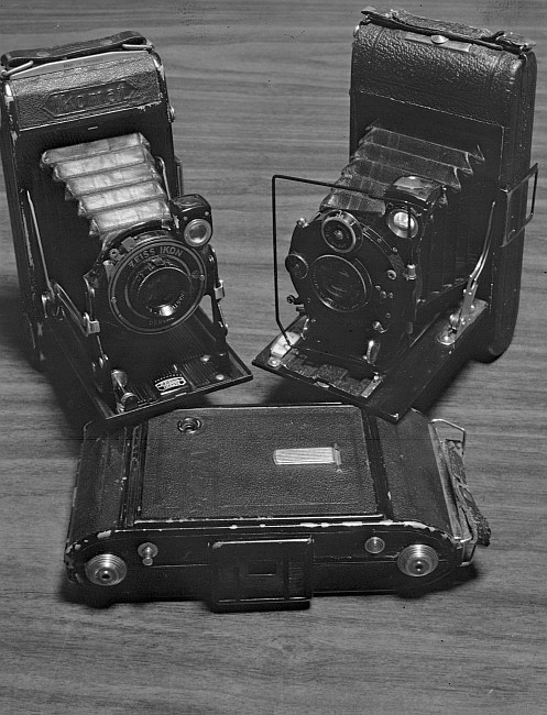

Okay, here are a couple examples developed in Parodinal.
Pentax Spotmatic SP, Super Takumar 50mm f/1.4, Tri-X, Parodinal 1:50
Canonet 28, .EDU Ultra 100, EI 400, Parodinal 1:50
Zeiss Ikon Ideal, 13.5cm f/4.5 Tessar, Fomapan 100, Parodinal 1:50
