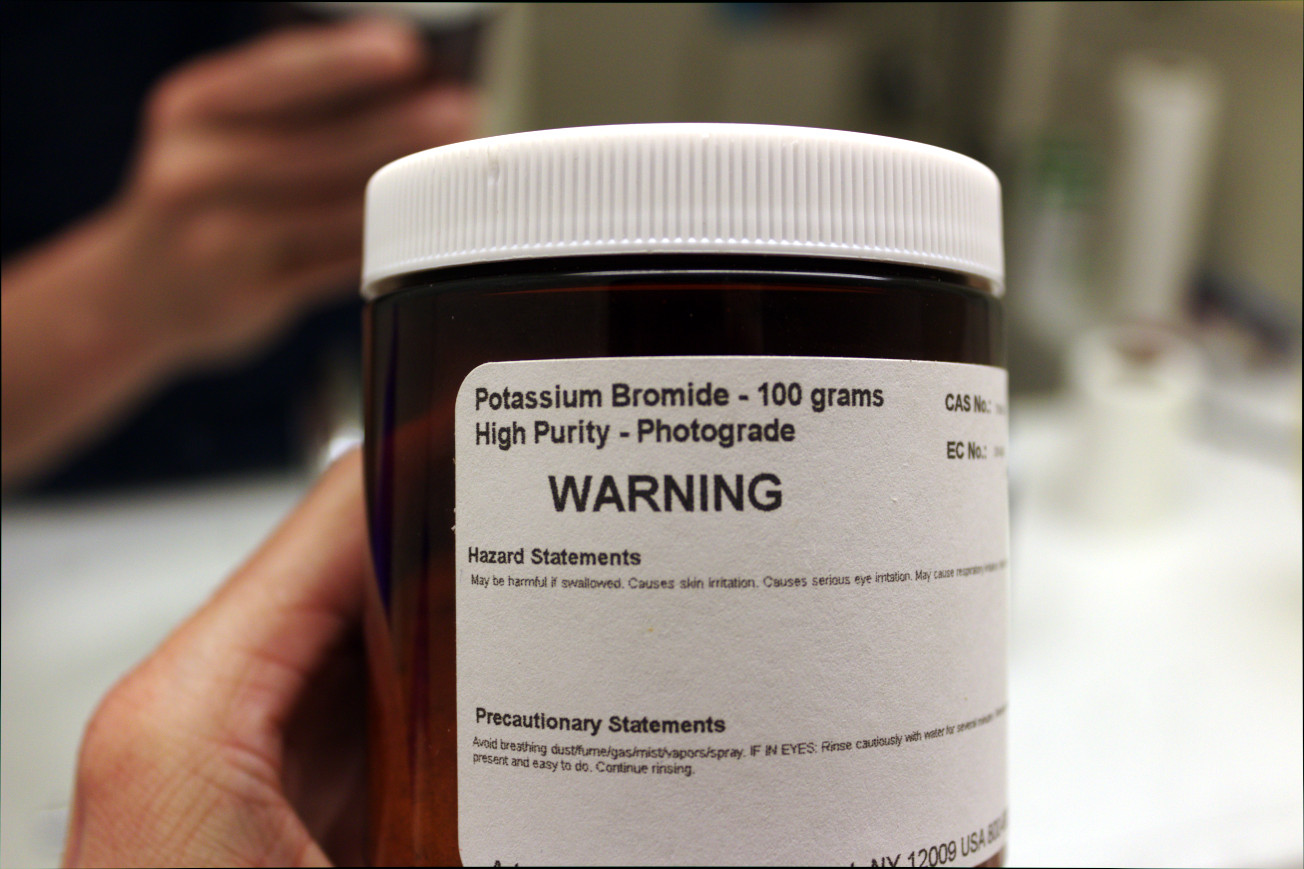

I was just wondering if slightly dark, slightly tanned, potassium bromide is still usable. I bought it a couple of months ago and it has been opened for use only twice. The container has been closed up good and put away in a dark place. Thanks.

I have been getting my chemistry from Artcraft. This is the only chemical that I noticed that has turned a little on the tan side.
When I first started mixing my own I ordered from B&H. I bought Metol and it was browned but it was still functional. After that I went to Artcraft.

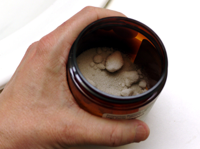

The browning is uniform. I will just order another 100 gram batch.

KBr is chemically stable in air. You can wash it with isopropanol or other organic solvents to see if it removes the color. Or you can try to recrystallize it from water to get higher purity. Most likely you don’t need to do any of those, though.

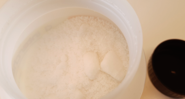

That looks nothing like the KBr I've ever purchased. Mine looks like somewhat coarser, white crystals, very much like sugar. It also does not discolor in any way unless I accidentally contaminated with traces of developer.
Yours looks decidedly impure.

I've had potassium bromide supplied as larger solid crystals that I needed to crush to use. No trace of brown in that or in the stuff I have now that's like what Koraks shows. Maybe some metol got in the jar and oxidized? If your developer is working fine with it, it's likely ok. But you can always contact the manufacturer.

According to the interwebs KBr can turn brown in the presence of chlorine gas. Displacement process of bromine. I don't have any chemicals that contains chlorine. No idea.
PVC releases small amounts of chlorine under normal conditions and bigger amounts when it's heated up. However, (1) the container that bromide is in doesn't look to be made of PVC and (2) the discoloration is too much to be explained from regular offgassing of a PVC container (even if one were used).
Contamination during manufacture is more likely. The brown discoloration need not be caused by discoloration of the KBr itself; it's just as likely (even more so) to be a contaminant that's present.
It's quite likely the performance of your KBr is indistinguishable from purer material in a real-world scenario.

As mentioned, your KBr most likely has a contaminant in it that is turning brown due to oxidation. Keep in mind that it's the contaminant, not the KBr that is being affected. The contaminant has been there since day one. You can likely keep using it and it will perform just as before, but mix up a smaller batch of D-72 first to check just in case.
I'd let Artcraft know that your KBr is turning brown. They likely don't wish to be providing contaminated chemicals. They may even replace it for you.
