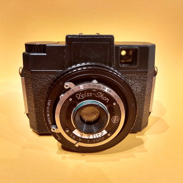

I also have on that has a proper shutter & focusing helicoid mounted on the front, with the holga's lens elements cemented in.
